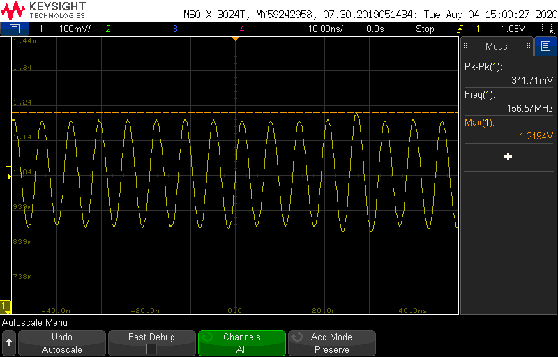

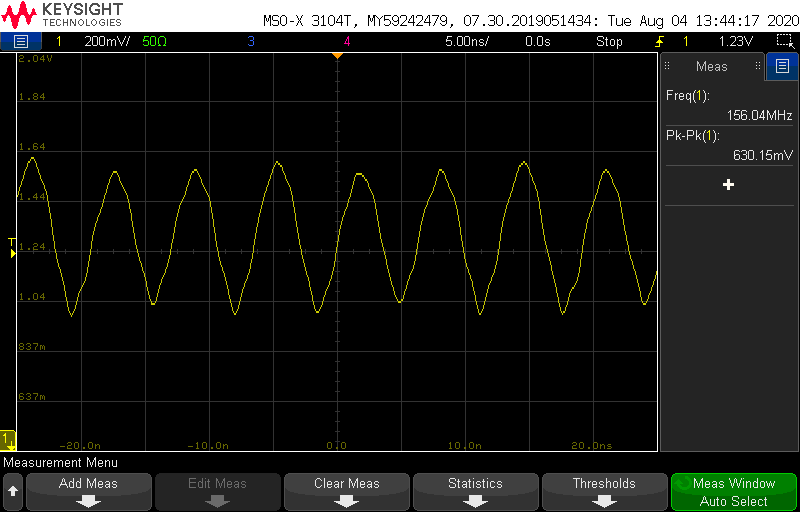

I have programmed my lmk to give an LVDS output of 156.25 MHz ,which i am giving to my Mgt bank in virtex 7 fpga.
I then used this clock for Aurora ip-core and Ethernet sub-system ip-core, but both ip core shows that there is no pll-lock. Just for testing purpose I then put a crystal oscillator of 156.25 MHz as a input clock to fpga during which time both ip-cores are showing pll-lock. i need to make both ip-core working with the lmk but unable to make it work. I have attached screenshot of both the clock
OSC CLOCK P
Below fig shows is the clk output i am getting from one of LVDS line of lmk. .
LMK   CLOCK P
Kindly Suggest.
  • Hello Prahlad,
    Nothing about the clock input looks obviously wrong (although from the signal distortion, I'm not sure the clock N is being terminated properly in this measurement). We need more information.

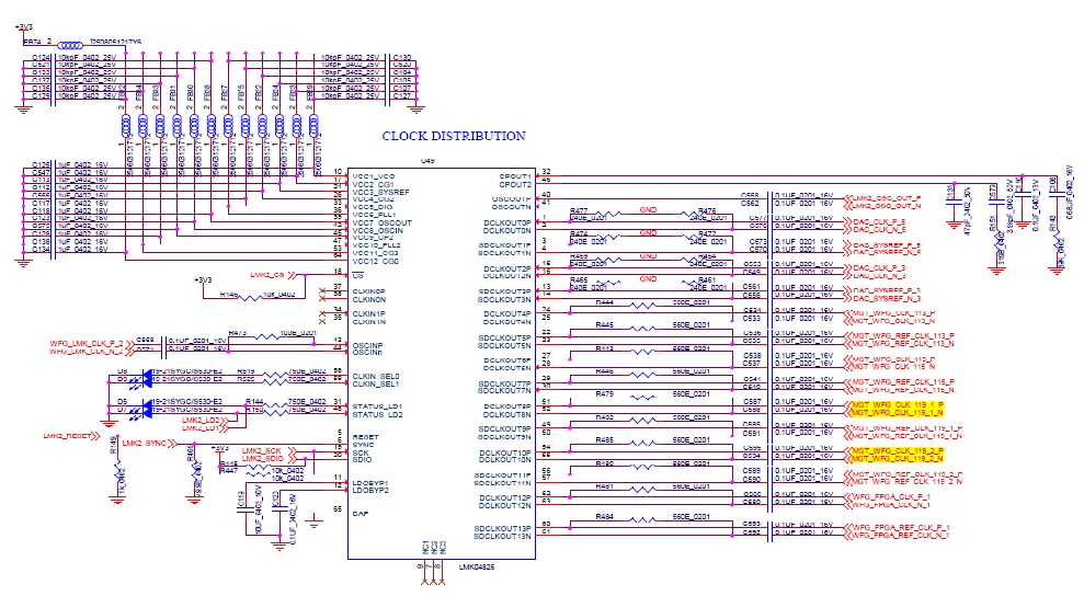

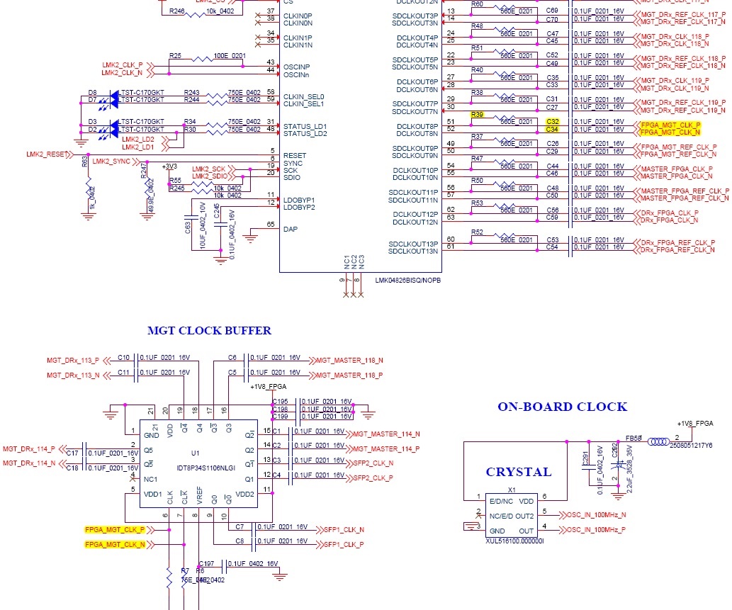

    First Schematic
    I am using oscillator clock for the below schematic on temporary basis to prove the code and it is working.
    To use the crystal oscillator output to FPGA, we have for now removed the highlighted capacitor & resistor and i have connected the oscillator output to FPGA_MGT_CLK_P and FPGA_MGT_CLK_N.
    Output of crystal oscillator goes through LVDS fanout buffer and then to the MGT bank of FPGA. Here by using the oscillator clock, I am not having any issue with the code.
    Second Schematic
    I am using LMK clock for the below schematic. Here, LMK output is connected to MGT bank of the fpga through coupling capacitor.
    There are two clocks going to the same MGT bank. Tried both of them but still the issue remains same.
    Highlighted the output clocks that are used for Aurora & Ethernet IP Core(DCLK8 & DCLK10)

  • Hello Prahlad,
    Thanks for sharing your schematics and register programming. Here's what I observe, in order of priority (first is highest priority):
    • Register programming shows OUT4/5 are configured as LVPECL, but schematic suggests LVDS. MGT_WFG_CLK_113 and MGT_WFG_REF_CLK_113 are likely not being delivered to their target.
    • PLL2_N_CAL register is set to 10, but PLL2_N is set to 5. PLL2_N_CAL should be set to the same value as PLL2_N to ensure the VCO calibration succeeds.
    • 100Ω termination on OSCin is on the wrong side of the input capacitors - should be located on source-side as per Figure 26 in the LMK04826 datasheet.
    Please make the necessary updates and let me know if the issue still persists.

  • Hi Prahlad,
    OK, so you are not using PLL1, then you can remove PLL loop filter.
    You said PLL2 is locked. If it is locked, then the frequency will be correct. Could you use a spectrum analyzer to measure the output clock? I want to know if it is stable and the frequency is accurate. Please also use a scope to check the voltage at CPOUT2, it should be a stable voltage at around 1.25V.
    Do a debug experiment to remove the 100Ω resistor that is connecting OSCin pins. What is the signal format on the left side of the DC-blocking capacitors? If it is LVDS, put the 100Ω resistor there to terminate LVDS driver properly.
