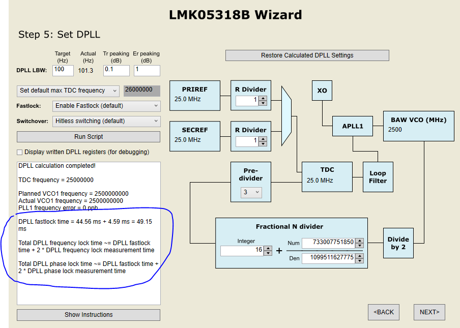

    The DPLL lock time can be found here (the new wizard for LMK05318B)
    APLL lock time is APLL wait time (<1ms for APLL1, 3ms for APLL2) + PLL analog lock time, which is approximately 1/BW (<1ms for both APLL1 and APLL2).

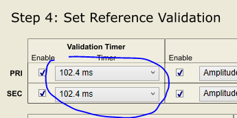

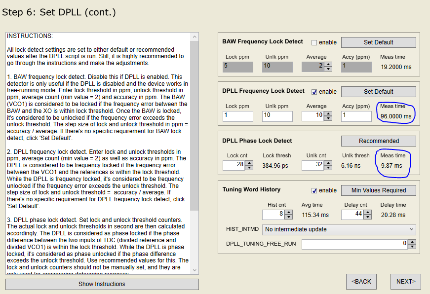

  • Hi Xinjian,
    Also letting you know that reference validation also takes time:
    The details can be found in the instructions box in that new wizard.
