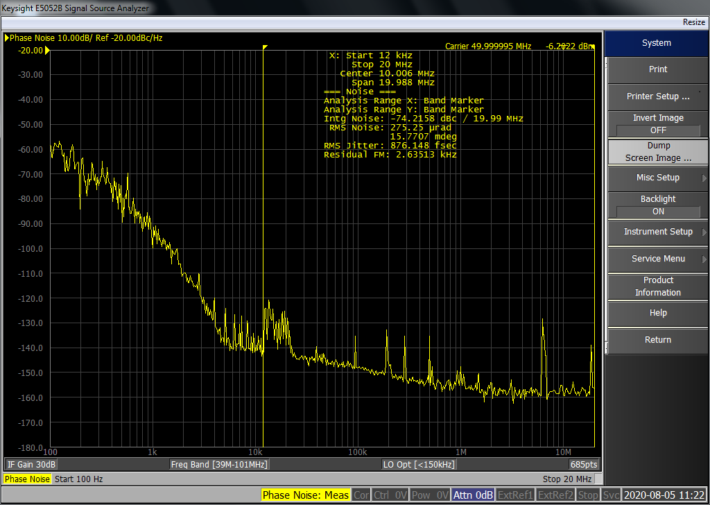

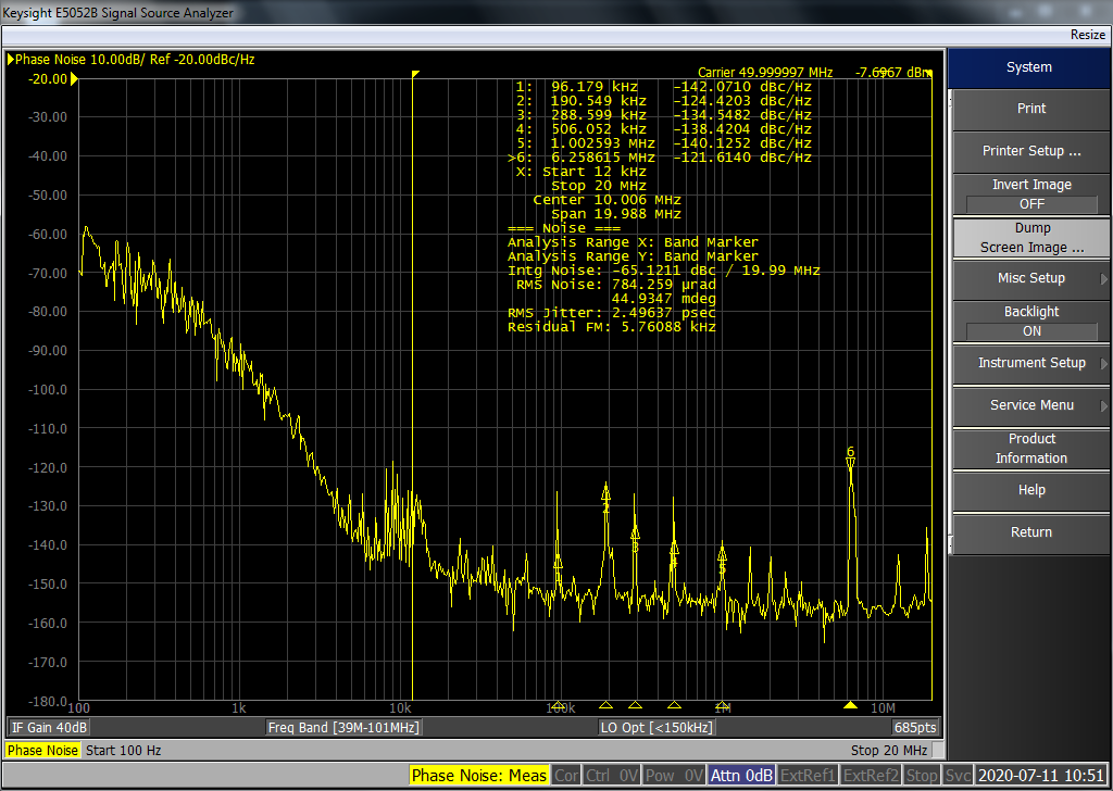

My customer is using the LMK00301 now. When they did the test with LMK00301 and competitor device. The same layout and the same board. But our QA4 and NQA4 jitter is 2.5PS, but other buffer QA4 and NQA4 clock jitter is only 876fs. Do we have some ideas about the phenomenon? Thanks.
LMK00301
The competitor
