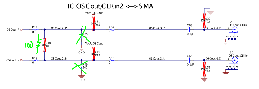

My design uses LMK04832 in a dual loop configuration. I use CLKIN2 for 10MHz LVDS reference for PLL1. In this setup, PLL1 does not lock.
I have tried to repeat this setup on the LMK04832EVM, but PLL1 would lock only on clock inputs 0 and 1, but not on CLKIN2 (it is enabled, either MOS/Bipolar, output is in powerdown).
is there a special register sequence that will enable the use of this input?
I have repeated the test on LMK04828EVB, but got the same results.

  • Hello Itamar,
    On the EVM, did you reconfigure OSCout/CLKin2 for input?  By default it has 240 ohm emitter resistors which would ground the input.  Ideally you would also place a differential 100 ohm resistor for a differential input.  If using a single ended input, a 50 ohm resistor to ground at R31 needs to be DC blocked by placing a capacitor at R33.  Normally C65/C66 would provide DC block.
    There is not special sequence except for disabling/powering down the OSCout and selecting CLKin2 as the input.  Are you using manual mode?
    If you are still having issues, could you post your saved. TCS file?

  • Hello Timothy,
    I have replaced the serial jumper resistors on clkin2's input with capacitors, and now it is working perfectly.
    Thank you for your help
