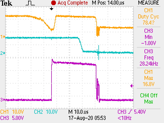

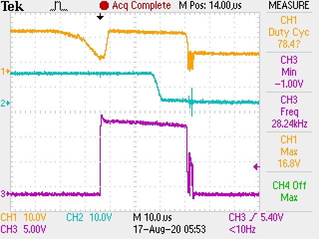

I feed 2 falling edge signals to pin 2(trigger) and pin 4(reset). I want output high whenever there is a falling edge signal on pin 2 and output low whenever there is a falling edge signal on pin 4.
Pin 6 and 7 are floating.
Here is what I get.
Yellow is trigger pin. Blue is reset pin. Purple is output pin.
Why the falling edge signal on reset pin does not make output low?
