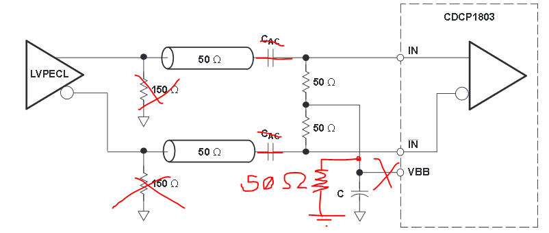

Question1-It is recommended in the datasheet , we need to connect the termination resistor 100Ohm at the differential input (IN+, IN-).
                  Please refer the below screen cut attachments.(Ref Datasheet- Pg-13)
                  Is this we have to follow the same if I am getting the LVDS differential input from 10MHz clock generator (Part No- Si570)?

  • A1. For an LVPECL input, you do not need to use the 150ohm bias resistors.

  • Hello Abhishek,
    One quick note on your prior question #3, the app note is within specification.  1500 bits per second is equivalent to 750 MHz clock.  Consider a data stream consisting of alternating 1s and 0s.  Then you have a clock.  If AC coupling, you need to make sure your data is DC balanced.
    As for your question on the output, I'm not sure the input requirements of your receiver.  Please take a look at application note SCAA059.  ()
    However you wouldn't generally bias the output to Vbb.  In general for an LVPECL output you must have a DC path to Vcc - 2 V or ground.  50 ohms to Vcc - 2 V (Vbb) is the simple thing for DC coupled LVPECL if Vbb is offered.  When not dealing with LVPECL receivers, often the simplest thing to do for LVPECL is to operate AC coupled.  To do so, place 120 ohm to 240 ohm resistors on each output pin to ground.  These are called emitter resistors and would be placed close to the LVPECL output.  Higher resistance values can be used like 240 ohms to reduce current consumption but will also slow down edge rates.  Then in series with each output pin is a DC blocking capacitor, often 0.1 uF is a good value.  These capacitors could be placed close to the transmitter or receiver.  Then at the receiver, place a 100 ohm termination across the input if it is not integrated.  This is similar to Figure 6 in the app note above.
      - Ideally the receiver will self bias, if not you do need to provide a circuit similar to figure 5 to bias appropriately.  Check your receiver datasheet.
    If you want to do DC coupled LVPECL, again nothing is required at the output.
      - If your receiver provides a Vbb, you can simply place two 50 ohm resistors on each P and N line to Vbb.
      - If your receiver does not provide Vbb, you can use a circuit as shown in Figure 10 of the CDCM1803 datasheet.
      - Finally on additional option for DC coupling LVPECL is a Y-termination as illustrated below.  The voltage divider between the 50 ohm resistors create a nominal 50 ohms to Vcc - 2 V.
