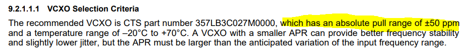

3, To what extent is the 27MHz VCXO XOin+ pin allowed to 27MHz±? Do you have specs?

    With regards to question 3, review VCXO selection section on the datasheet:

    Q.3,: OK, I'll check the section.

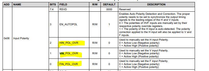

    Q.8 I'd like to know Whether the input pulse (to Fin, Vin or Hin)  responds to rising edge or falling edge.
           In my understanding, it depends on 0x06 register (Input polarity) setting, "Active Low"-> "Falling Edge" and "Active High" -> "Rising Edge."
           Is it correct?

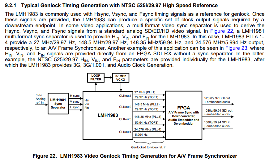

    Q.9  In the figure28 on the datasheet, It is written only Hin. In this case, should I do about Fin and Vin.

    Only Hin signal is needed to lock the PLL. Vin (and Fin for interlace video input) is only needed to align the output TOF pulses.

    Default polarity is to lock to the falling edge, but it can be flipped to toggle to rising edge through register:
    I understand It is answer for Q8.

    If Fin and Vin are not used you should be able to leave them floating.
    I understand It is answer for Q9.
