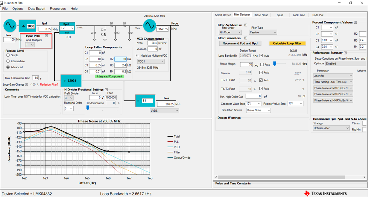

I faced a problem in locking PLL2 when I enabled the doubler. The configuration is shown as below:
From the datasheet, I saw that enable double can get better phase noise result and in some of the previous design that use LMK04832 had also enable the doubler but didnt not face any issue. But for my case, when i enabled the doubler, the PLL2 unable to lock. If i disable the doubler and change the R2 divider into 2000, the system able to lock. This sounds weird to me as i thought enable double can reduce the phase detector frequency and hence should able to lock easily than that without doubler.
I also attached the image for PLL2 loop filter parameters, from PLL Platinum the phase margin looks good and jitter also very small. I doenst sure what cause the PLL2 unable to lock in this case. Besides that, I wondering how to use the input mutiplier in PLL Platinum Sim, I initially thought it is refer to the doubler, but it seems it is not. Can explain more to me how to use this input multiplier as well? Thanks.

  • Hi Vibhu,
    How can I compare the simulation using PLLatinum Sim with double enabled as i noticed the input multiplier is not functioning(maybe I do not know how it work for this input multiplier). I got try to change the input =200MHz instead of 100MHz and R=4000 instead of 2000 to simulate the case of doubler enable, but doenst seem any changes in the result. Maybe you can show me how to configure with enable doubler in PLLatinum simulation tool in this case. Thanks

  • Sorry I have overlooked this before the reply. Could I trust the filter design on PLLatinum Sim? As Ee Wen pointed out before, the software shows our filter is stable.
    Regarding the Phase Detector frequency, unfortunately, I can't really change it as I need the resolution. I could accept a degradation on the phase noise performance but if the loop would not even lock this is a problem. In the datasheet there is no Min Freq specified for Phase Detector frequency, any other way I could make this work?
  • Hello Hao,
    Yes the filter designer is accurate for typical conditions as this is a simulation tool. The farther you go from a common use case the less accurate the simulation will be. In your case the extremely low phase detector might not give you a perfect simulation.
    I understand that a higher phase detector frequency is not acceptable in your design. However, I would experiment with a higher phase detector frequency to get the park locking. If this locks but your setup doesn't then unfortunately, there's not much we can do except maybe trying different loop filters. This may include increasing the phase margin for more stability. If increasing the phase detector frequency does not help it could be related to the loop filter.
