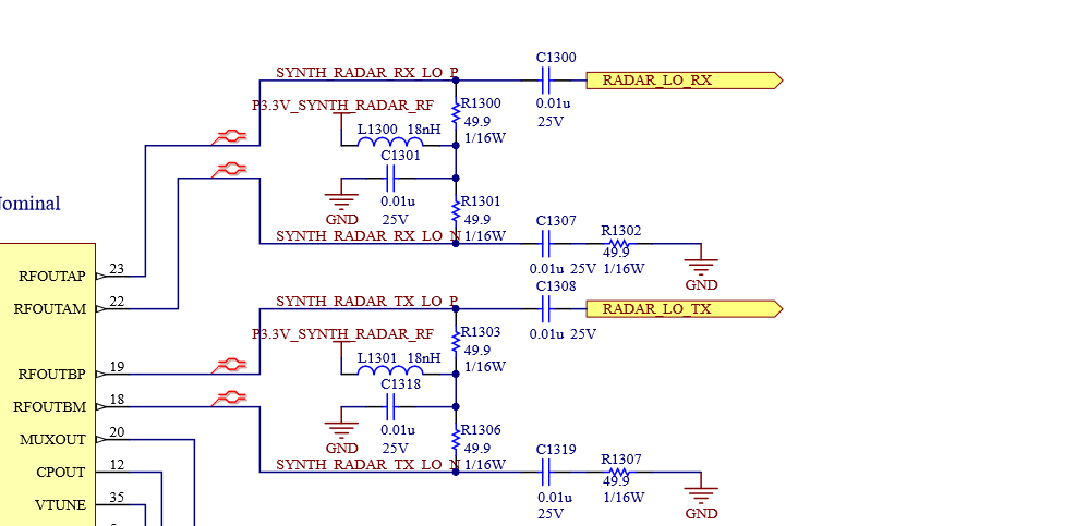

  • Noel,
    Below is the snippet of our hardware and the LMX2594 EVM schematic. They appear to be identical. Along those lines, the circuit for our hardware's output A and B are identical as well. So it seems strange to me that the output of A works but B doesn't.

  • Hi Jacob,
    Schematic is good. Did you check the soldering quality?

  • Hi Jacob,
    EVM and production device are currently the same, that's just a date code difference.
    Is it possible that any of the components on RFoutB are improperly soldered? Do you have another board on which the issue is replicated?
    Can you try switching the pull-up components for RFoutA and RFoutB?
    Since you have your own schematic, you are using your own PCB, yes? Could the layout of your PCB and the location of your 3.3V connection for the RFoutB components be contributing to the reduced power?
