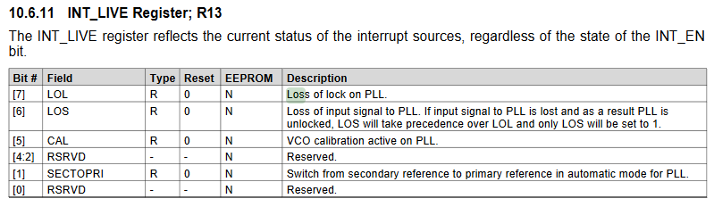

    When there was no clock output, LOL and LOS status were normal. Are there any alarms to detect that there is no clock output?

    When you say LOL and LOS were normal, do you mean the device indicated lock?
    Vibhu
  • Hello Vibhu,
    Yes, There were no alarms in register R13.
    JH
  • Hello JH,
    These are not sticky bits, these bits indicate the current status of the register. It may be beneficial to use one of the STATUS pins to indicate LOL for debug purposes, that way you can see the LED turn on or off.

  • Hello Vibhu,
    Please explain in more detail.
    What does it mean that LOL and LOS of R13 indicate the current status of the register? Doesn't it indicate PLL status at the moment of reading?
    What STATUS pin setting should be selected for the LED turn on or off ? Does it keep updating the current PLL's lock status? or does it remain changed once?
    Thanks a lot.
    JH
  • Hello JH,
    Yes, the LOL and LOS in R13 indicate the current status, status at the moment of reading.
    INT_FLAG register R16 can be used to see if the device ever flags LOS or LOL. INT_FLAG register is used along with INT_FLAG_POL (R15), INTCTL (R17) and INT_MASK (R14). Please read the descriptions of these in the register maps if they are of interest.
    For example, if the device loses lock and regains lock, R13 will indicate lock, while R16 will indicate the device has lost lock in the past until cleared.
    The STATUS pins are similar to  the INT_LIVE registers, however, if you are looking at the LMK03318EVM board you will be able to see the LEDs turn on/off.
    R27 and R28 can be configured to indicate different signals on STATUS0 and STATUS1 pins.
    Vibhu
