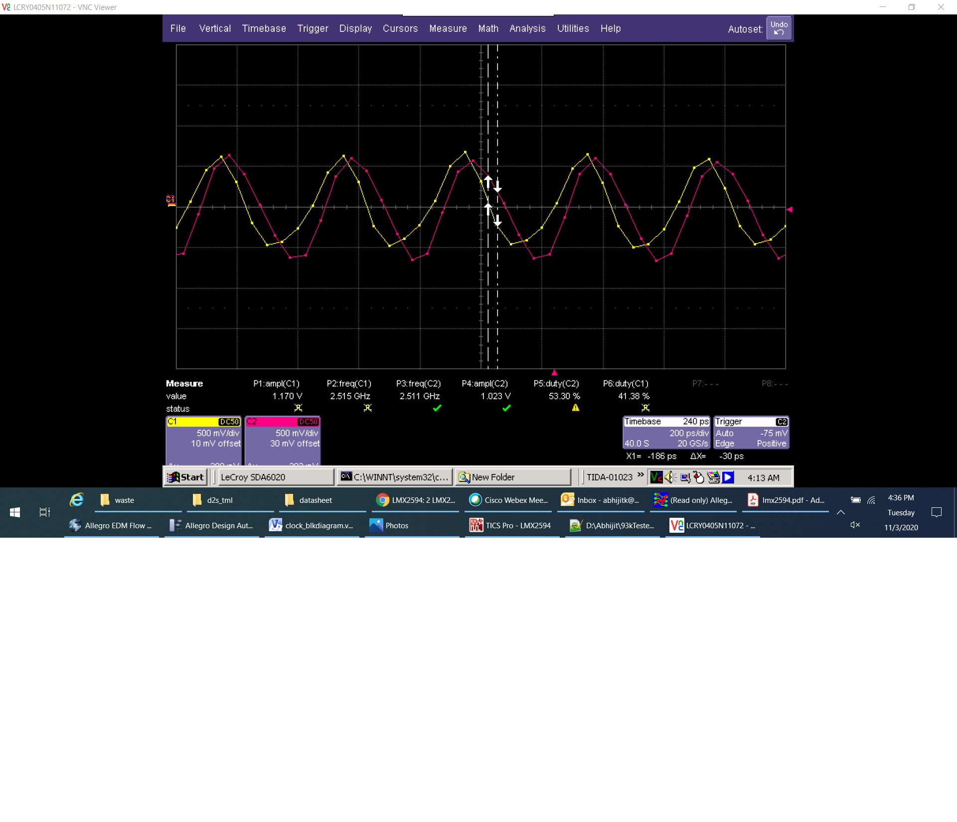

  • Hi Vibhu,
    When i configure the output of both LMX at 1.25GHz it has a duty cycle of 65-70%. For the same set of outputs configured to 2.5GHz the duty cycle seems to be 42%.
    Also the 1.25GHz waveform has does not look clean as 2.5GHz waveform. How can i improve it?
    Please refer the attached files.   thanks, Abhijit
  • Hello Abhijit,
    Can you confirm that your device is locked? The easiest way to do this is to close MUXout_SW (refer to EVM schematic) pins 2 and 3 so the LED is connected.
    The LED will light up when the device is locked.
    Always toggle FCAL_EN to lock VCO after changing frequency. This will likely not be needed because you will be using the same VCO frequency (10 GHz) with different channel dividers.
    With higher channel divider values the waveform is expected to look more and more like a clipped sine wave. So this behavior is somewhat expected however your waveforms don't look the cleanest.
    If you are measuring these outputs single-ended, then make sure you terminate unused output pins with a 50-ohm termination.
    Please let me know if any of these suggestions clean up the waveforms.
    Vibhu
  • Hi Vibhu,
    The easiest way to do this is to close MUXout_SW (refer to EVM schematic) pins 2 and 3 so the LED is connected.--- I checked rb_LD_VTUNE in R110[10:9]. I am seeing 10 in these two bits after the LMX is configured.
    The LED will light up when the device is locked.---I am using a board which does not have LED.
    Always toggle FCAL_EN to lock VCO after changing frequency. This will likely not be needed because you will be using the same VCO frequency (10 GHz) with different channel dividers.---Making this bit 0 and then 1 after every configuration write of LMX SPI registers.
    With higher channel divider values the waveform is expected to look more and more like a clipped sine wave. So this behavior is somewhat expected however your waveforms don't look the cleanest.---After changing the PLL divider, i am able to get 50% duty cycle. Now i am using 625MHx instead of 1.25GHz. See attached waveform.
    If you are measuring these outputs single-ended, then make sure you terminate unused output pins with a 50-ohm termination.---Yes.
    Please let me know if any of these suggestions clean up the waveforms.---Now the waveform looks clean. Thanks for your support.
    Thanks, Abhijit
