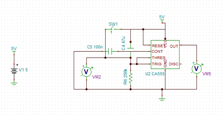

I want to use NE555 to realize the timer function. When the timing time is not up, the output is low, and after timing 2s, it outputs a high level to the subsequent circuit, which is used as an indication to the subsequent circuit. I have designed a circuit as shown below.
But I think this circuit is not prefect. Because at the beginning, the output is high which is similar with the output when times up. It may cause some error to circuit. Could you please comment on which circuit could realize the function as I mentioned above? Thanks a lot!

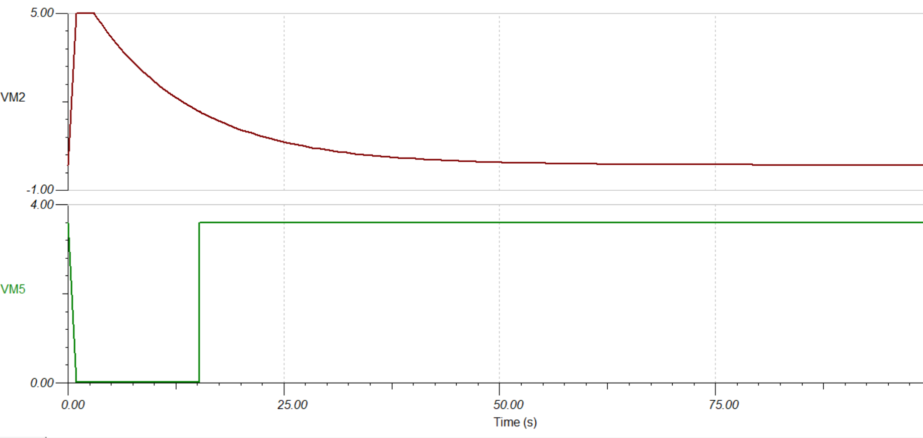

Do you want the timer for 2s to start when the NE555 is powered on? What is the function of your switch in the real circuit? It looks like you close the switch for 2s and then the timer is low for about 14s which means the period of your timer is about 12s (not 2s). The output starts high because there is a low voltage on the THRESH/TRIG pin when the NE555 is powered on. If you start with the switch closed then the voltage on the THRESH/TRIG will start out high until you open the switch and the 47uF cap discharges. Will this solution work for you?

Let me make it more clear. I think this solution is work for me!
Function:
After power-on, I need NE555 output a low level signal and NE555 starts timing, such as timing 14s. After the timing ends, I need the NE555 output a high level signal. This high level output will be used as a trigger signal to the subsequent circuit.
Do you means at begin I need to close switch first and then open the switch, then the output is what I want, right?
Is there a solution that does not require switch operation?
Thanks!

The timer will start on powerup with no switch if you use this configuration:
C3 starts low (triggers the timer) and charges through R1 and the period of the timer is set by 1.1*R*C, the values I use have the timing set to about 14s. The output is inverted to get the waveform you want using an NPN transistor. The power has to be cycled for the output to be able to return low again.
