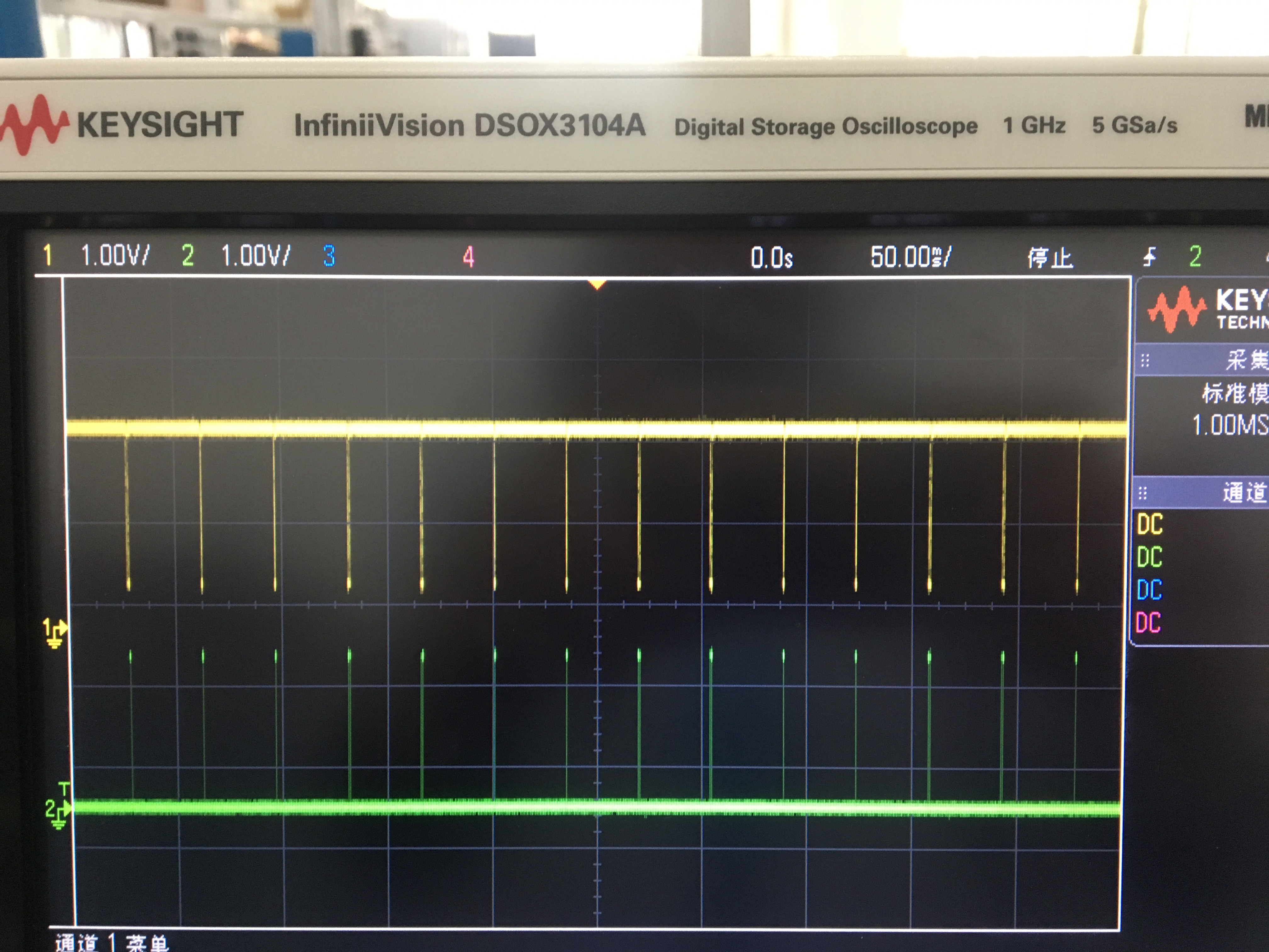

   The MUXout pin of lmx2594 on my board is used for Lock Detect,LD_TYPE is set to 1 and LD_DLY is set to 1000.
When the pll is unlocked on my board,i measured the output of MUXout pin without anything writing,the waveform is as follows,
From which we can see a low level sometimes, but there is a period of high level about 260us,Why?Is this normal?I always thought that if the PLL is out of lock, then the muxout should always be low level.
I can see the pll is indeed unlocked from spectrum in the meanwhile.
