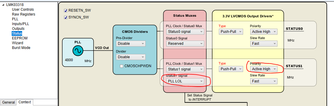

  • Hi Eric,
    First of all, check if the PLL is locked. To do so, measure the voltage on pin STAT1. In the configuration that you sent, STAT1 is active high, meaning that if the voltage is 3.3V, then "LOL" status is active. LOL stands for Loss of Lock. Therefore, high means not locked and low means locked.
    If the PLL is locked, check if other outputs can successfully generate a clock. Since there's only one PLL, all the outputs share the same source. If one output cannot generate a clock, then the problem is with that output.

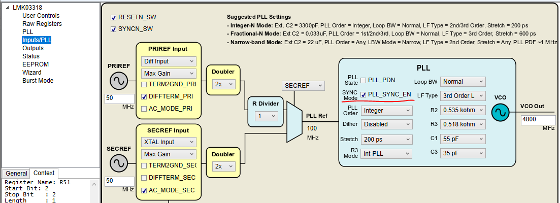

    Try disabling the output synchronization and see if that helps:

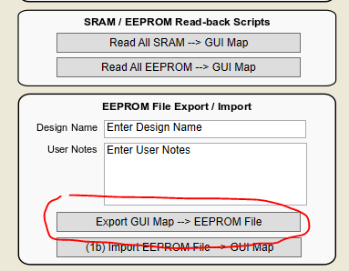

    Regarding the EEPROM programming, to verify whether or not the EEPROM is successfully written, it's recommended to use the "direct access" method. You can generate a EEPROM image from Ticspro by clicking this button:
    You can also directly read the EEPROM image back from a chip. If you don't have access to a USB2ANY, you can try implementing that yourself according to the datasheet. The goal is to compare the two EEPROM images (written and read). The first 10 bytes are protected so it's OK that they're different. The rest bytes should be exactly the same.
    The reason why this is needed is because not all registers are stored in the EEPROM. There're read only registers and some other registers that don't need to be stored. Therefore if you read back registers you may get different values.

  • Progress!
    First of all, yes I have checked PLL lock by looking at STAT1 and it has always been good, meaning Loss of Lock if Off.
    Your suggestion of turning off PLL_SYNC has improved things.  Now, when I boot with HW_SW_CTRL=0 and read back the latest settings from the EEPROM, I now get a good 160 MHz on OUT0.  PLL Loss of Lock is Off.  However, I have never achieved a good clock on OUT7, whether I just write the registers over I2C or cause them to be read from EEPROM.

  • Hi Eric,
    That might be because of the prescaler setting. In general, the prescaler shouldn't be set to 2 if output sync is ever needed (which is mentioned in the datasheet). So you can either keep the sync off or select another solution with prescaler not equal to 2.
