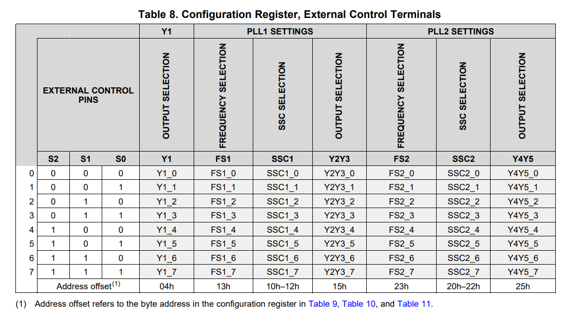

My customer is looking for a clock IC. Could you let me know the recommended device which can meet following requirement? Is the CDCE925 closest device?
・ With VC control function (range is ± 100ppm or more)
・ Clock output is 2ch (or more)
・ The following output frequencies can be output exclusively.
(1) 74.250MHz / 74.17582MHz (switchable)
(2) 48MHz
・ If possible, (1) can be controlled from a general-purpose I/O port with High / Low.
