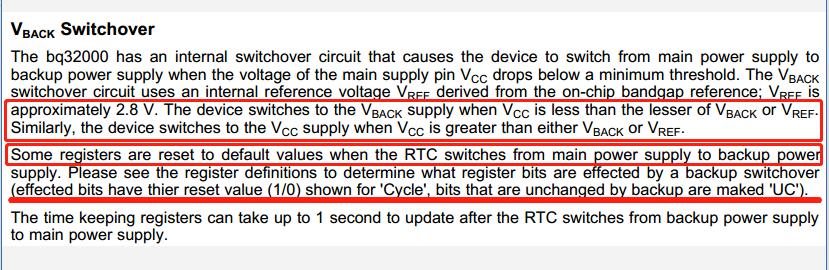

From datasheet,
is that means OF is 1 initially, but when switch from VCC to backup supply, OF will be reset to 0?

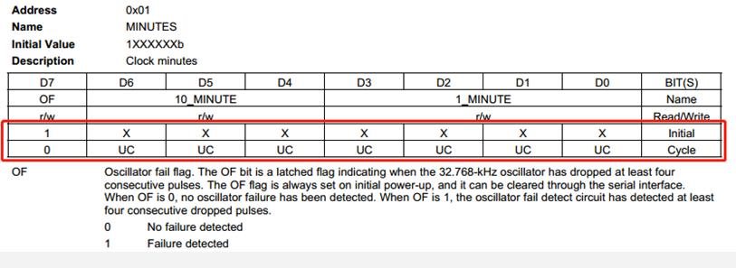

when the OF will be set as 1. here said The OF bit is a latched flag indicating when the 32.768-kHz oscillator has dropped at least four
consecutive pulses.do we have more description for "drop"?

  • Yes, OF is 1 initially and is reset to 0 on backup supply switchover.
    "Dropped" means that the crystal oscillator did not produce at least four consecutive periods of the 32KHz clock

    1. According to the DATASHEET and your reply, The statement that "originally the OF flag bit was 1, but when switching from VCC to backup power supply, the OF will reset to 1" is confirmed. However, in our test, we manually sets OF to 1, and after the following 2 ways that lead to backup switchover, OF could not reset from 1 to 0:
    A. Disconnect the VCC directly, so that the IC will be forced to switch to the backup power supply (we uses 3V battery as the backup power supply);
    B. Manually reduce VCC from 3.3V to 2.3V gradually(2.3V is lower than backup power VBACK 3V and internal reference voltage VREF 2.8V);
    Therefore, we wanna know further whether the backup switchover mentioned in DATASHEET includes the above two scenarios. If so, why the result differs from the DATASHEET, if not, what is the meaning of the backup switchover actually;

    A1. Yes, the datasheet statement on supply switchover would include these two scenarios. Based on the wording in the datasheet, I would expect that OF = 0 after the supply switchover.

    Thanks for your reply, following is our information for your questions, and the bottom is my confusion.
    A1.The XTAL we used is 9H03200031 from TXC Corporation. The nominal frequency of this XTAL is 32.768kHz, the load capacitance is 12.5pF, and ESR is 70KΩ at maximum, which all meet the requirement of BQ32000 datasheet.
    A2.The oscillator does not drop any pulses when switching from VCC -> Vback -> VCC.
    No matter OF = 1 or 0 before VCC -> Vback -> VCC, OF keeps the original value after switchover.

    Thanks for the information. Based on your findings, it seems the datasheet has a typo and OF is unchanged on supply switchover.
    I will submit the request to confirm this behavior and update the datasheet.
