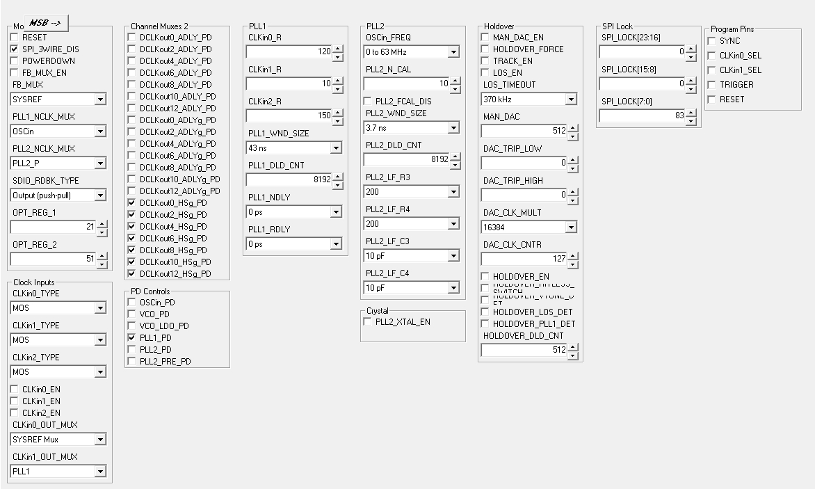

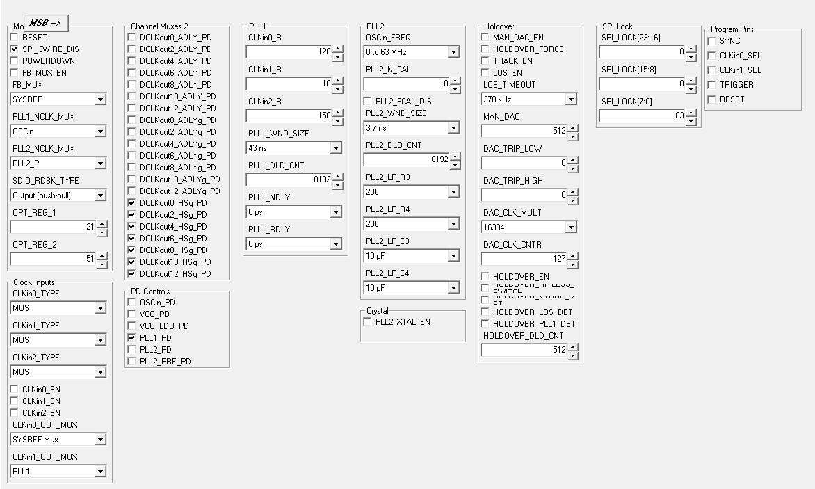

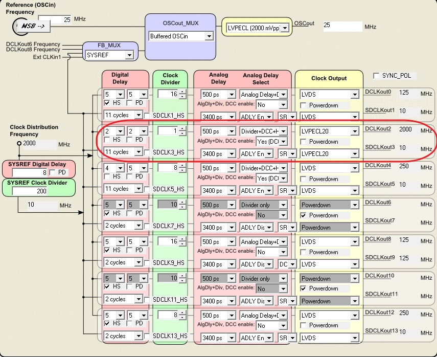

We've encountered phase unlocked issue when we utilize LMK04821. Hope you could help us out.
When a DCLKOUT channel is configured with DCLKoutX_DIV=1, this channel will lose phase locking with other DCLK channels. When DCLKoutX_DIV>1, this channel will be well synchronized with other channels.
My configuration are shown below:
