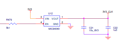

    Our board level 3.3V is generated by a LTM4676AIY#PBF regulator with 10 x 100uF decoupling caps on its output, this is the fed to the power switch below:
    As I said earlier while debugging chip 2, we permanently enabled this so its on from start up as the only way to make it start up with out melting.
    The LMX circuitry is then:
    The input clock is sourced from a 10 MHz clock splitter, AC coupled with 100nF caps.
    The SPI buffer is to allow us to disable the 3V3_CLK rail and it ensures the SPI signals to high impedance.

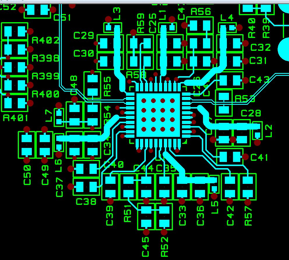

    If neither of the above are applicable, could you share some images of the PCB layout around the LMX2594? Since it seems there is some board dependence related to this issue, perhaps the layout could provide a clue.

    Below is the top layer of the layout around the LMX2594:
    And below is the bottom layer of the same area:
    Please let me know if you need anymore images.

    Nothing in the layout stands out to me.

    • Probed every pin on the device with the chip attached, all resistances pretty well match our working board.  Input Vcc rails are of order 9k ohms, all rails generated by your device are of order Meg ohms.
    • Probed every pin on the footprint with the device removed, all resistances as before, nothing low or a short.
    • We've now wired a 2594eval board into the board, so using our input voltage supply, clock input and output circuits and SPI buffers and it all works perfectly, so I don't think its anything outside the immediate area of the part.
    I was hoping you could narrow it down a bit to, its this voltage rail or this oscillator turning on, or when it starts tuning, or something to give me a clue.
    Bryn
  • Bryn,
    Given the steps that you've taken above, it seems like there could be two different issues combining to make debug difficult:
    1. Some kind of damage caused by a defect in the PCB. Perhaps this is a cracked power delivery via, an improperly milled inner layer route that causes a short from some pin to GND under strain/thermal expansion/other mechanical stresses, etc. Insidiously, the fault condition could show up only intermittently when the right thermal or mechanical stress is applied. If it's temperature-related, you may be able to locate it by heating the board up or flexing it and looking for shorts or opens between the device pads and the traces leading to them. It sounds like you already looked for damage before, but perhaps not with thermal or mechanical stresses applied? An alternate test could try to power up the board with no LMX2594 populated, then apply a heat gun to the device area or flex the PCB while looking for shorts or opens.
    2. Whatever happens on the PCB cooks the LMX2594, and the device permanently becomes significantly more susceptible to failure. Perhaps re-apply one of the bad parts into the LMX2594 EVM and check if it works as expected to confirm whether or not there's device damage after whatever event occurs on your own PCB. If there is some permanent damage to the device after use on the faulty board, I'm not sure how we can reliably separate the board defect from the device damage. On the other hand, if the device works on the EVM, it must be a board defect alone that causes the problem since you've already replaced every component around the device.
    Based on the results of your current measurements, I suspect that you should be paying close attention to the traces on VccVCO2-related pins (25-30). I do see that there's a via on pin 25 to GND that is partially off the bottom-layer ground, and I'm not sure if there are additional layers within the board; I wonder if there is some uneven mechanical stress on this via due to placement? Note that damage to the VCO-related circuitry is consistent with your report that the device behaves well when in powerdown or reset state, as both states should temporarily disable the VCO.
    If you really need this board to work at all costs, you could try removing the pads and traces, and manually wiring pins 25-30 to their destinations. An alternative for the grounded pins is cutting the traces to the vias and shorting the pins to the central pad beneath the die.
    I'm not sure how else we can help you. All signs point to this being an issue with the PCB, and not the LMX2594. Beyond what I've suggested, I'm not sure there's any remaining device-specific knowledge that we could impart which would shed light on the situation.
