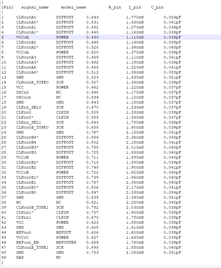

My customer found the C_pin of OSCin of IBIS model (0.037pF) , but in datasheet, it is 4pF typically. What is the exact definition of R_pin/L_pin/C_pin in the IBIS model?

In fact, the customer would like to double confirm if the IBIS model parameter is accurate enough for simulation, especially for CLKin, CLKout and OSCin pins.
