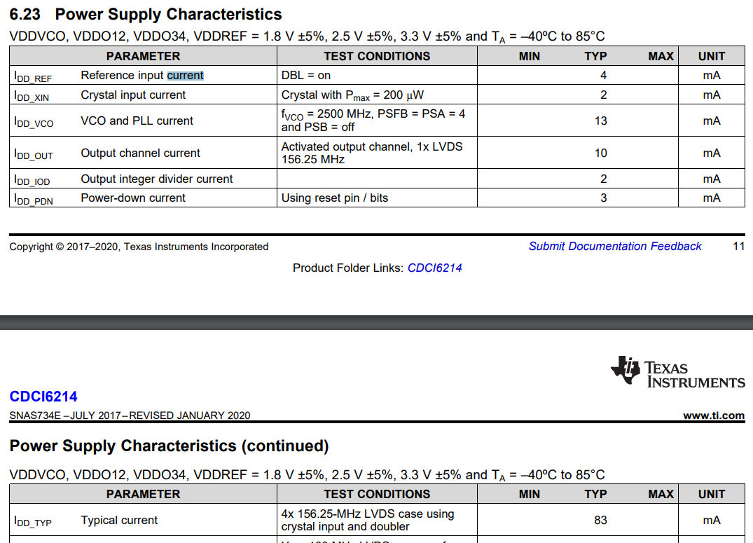

Hi Team,
May I know if there is any tested data about power consumption when CDCI6214 is powered by 1.8V and 3.3V? Thanks!
Best Regards!
