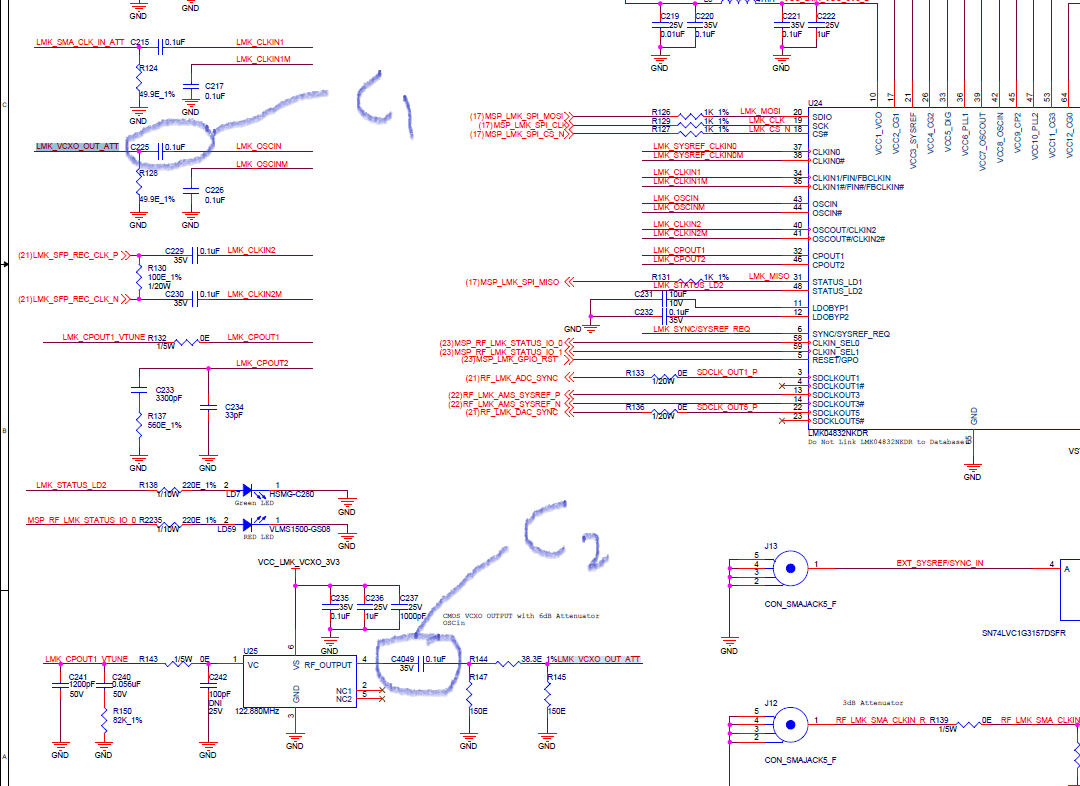

Hi team,
May I request you to review the attached schematics that includes  LMK04828/LMK04832 and LMX2820?
Specifications for LMX2820:
Output Frequency @ RFOUTA : 5Ghz  or 10Ghz
Fosc = 100MHz
Fpd = 200MHz
Kpd = 15mA
Fvco = 10000MHz
Specifications for LMK04828/LMK04832:
PLL1 - VCO0
CLKinX = 10MHz
CP for PLL1 = 0.15mA
VCXO frequency = 122.88MHz
VCXO gain = 8kHz/V
2nd order filter
PLL2 - VCO0
CP for PLL2 = 3.2mA
VCO frequency = 2457.6MHz
VCO gain = 21.9MHz/V
4th order filter
Kindly let me know if you need any other information that would help your review.
Keerthana
