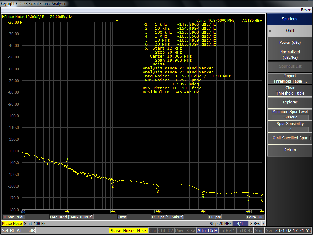

  • Sai Kiran,
    Compare the phase noise plot below, taken from the channel divider maximum divide at an arbitrary VCO frequency, vs. the SYSREF output phase noise data in the previous post. There is around 10dB worse performance at the SYSREF noise floor, and the RF output is 1.5x higher frequency.
    I don't have any data on the SYSREF VODIFF min/max, because as far as I can tell this has not been characterized. Based on the previous post phase noise plot, it looks like just under 10dBm output power differential into 100Ω load (measured through a 2:1 impedance balun into 50Ω single-ended), which is just under 2Vpp VOD.
