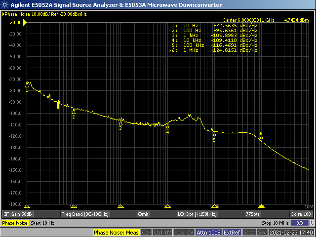

A phase noise of LMX2820EVM is bad.
Result of a measurement is far apart from simulation.
Please give me advice to become same as a simulation result.

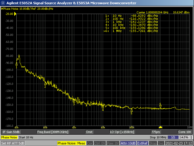

Your OCXO phase noise is very good, hope the spurs are not real and is just a measurement issue.
Given this good phase noise, I don't know why the phase noise of LMX2820 is bad.
Were you using the "EVM default mode" setting but just change the output frequency to 1.7GHz?
Could you also try other reference clock? For example, signal generator? You could try with 800MHz reference clock and then set Pre-R = 4 to get the same 200MHz fpd.

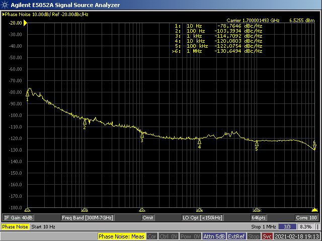

Hi Arai-san,
When did you order this EVM? What is the part number as shown in the top marking of the device? Is it LMX or PLMX?
The noise bump between 10kHz and 100kHz could be reduced by increasing the bypassing capacitor at pin 3. Change this capacitor to 4.7µF or larger.
Higher input frequency or input power improves phase noise suggests that the slew rate of the reference clock is also important. If possible, use a square wave reference clock. Also try use a sma connector (aka I-join) instead of sma cable to connect the OCXO and EVM together.
Changed to 2.2uF.
Phase noise has improved by about 0.5 dB.
Do I need to change Register2's INSTCAL_DLY as a result of the change?
Also, I'm not using INSTCAL_DLY right now. (default)
Phase noise is about 1dB worse.

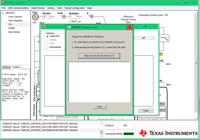

Actually, our USB2ANY has a problem.
For this reason, we are using the supplied USB2ANY of LMX2592EVM.
Is there any change in measurement due to the difference?
USB2ANY we received had an initial failure and have never been able to use it.
To request a replacement, we’ve called TI support team, opened a support request, asked on e2e , and we’ve also requested product return.
However, none of them were in charge for the replacement, and our request was declined.
We just want USB2ANY to be replaced. Can you support our request?
Hi Arai-san,
Every USB2ANY is identical, you can use the USB2ANY that came with LMX2592EVM.
I cannot replace your USB2ANY, I don't have this capability.
If you use a new PC that have never been connected to an USB2ANY (or, you can remove the USB2ANY driver from the PC that you have been using with USB2ANY), when you plug in the non-working USB2ANY, will you get prompted to update the firmware?

Press the BSL button and nothing changes.
