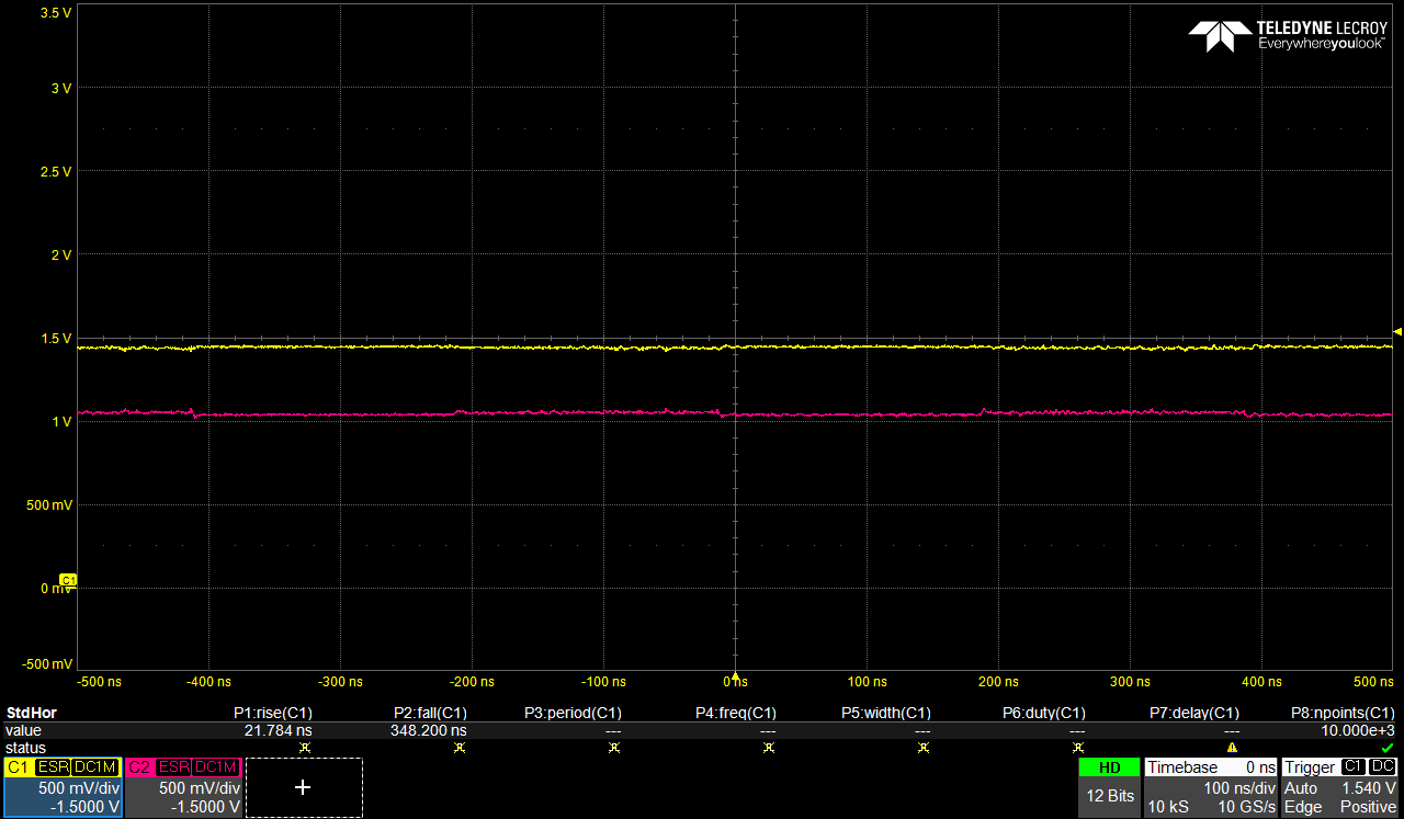

LMK04832: No SYSREF output on SCLKs
Part Number: LMK04832
Other Parts Discussed in Thread: LMK04826
I'm working on migrating a design with an existing PCB from LMK04826B to LMK04832. The board was working properly prior to replacing the PLL. Our source code has been updated to match the changes in the register map of the PLL, but it looks like we've missed something as I'm not getting any SYSREF signal on any of the SCLK outputs.
Some troubleshooting I've attempted:
- Tried both continuous and pulser output from the SYSREF_MUX, neither shows up at the SCLK outputs
- Tried switching the SCLK outputs to device clock via the CLKoutY_SRC_MUX, which works fine and outputs a clock signal
- Tried toggling SCLKX_Y_POL for the SCLK output, which works and causes the output to toggle
- Tried measuring the SYSREF_DIV clock via OSCout, using FB_MUX == SYSREF_DIV and OSCout_MUX == FB_MUX. This shows correct signal, 2.5 MHz with 50% duty cycle- Tried enabling/disabling parts of the SCLK signal path (DDLY, analog delay, etc), but none of the changes result in SYSREF output
Given that I've verified that SYSREF_DIV is OK via OSCout, and that the signal path from SCLKX_Y_POL and out to the PCB is OK by toggling the polarity, I'm assuming it must be something in between that stops the signal? SYSREF_CLR is zeroed when I'm doing these measurements.
The two PLLs both signal lock detect. I'm using a 10 MHz reference into PLL1, which controls a 100 MHz VCXO. PLL2 goes from 100 MHz to 2.5 GHz. PLL1 uses SYSREF_DIV as feedback, PLL2 uses local feedback via prescaler. SYSREF_DIV divides by 1000 to get 2.5 MHz. The outputs where I want SYSREF output are CLKout3, CLKout9 and CLKout13.
I've attached text files containing a readout of the register map, plus a parsed version where I've extracted the values of individual fields in the registers for easier reading.

Register 0x100 = 0x0A
        DCLK0_1_DIV[7:0]   10
Register 0x101 = 0x00
       DCLK0_1_DDLY[7:0]   0

Register 0x104 = 0x34
         CLKout1_SRC_MUX   1  == SYSREF
              SCLK0_1_PD   1
        SCLK0_1_DIS_MODE   1
             SCLK0_1_POL   0
              SCLK0_1_HS   0

Register 0x138 = 0x18
                 VCO_MUX   0
              OSCout_MUX   1
              OSCout_FMT   8
Register 0x139 = 0x03
           SYSREF_REQ_EN   0
             SYNC_BYPASS   0
              SYSREF_MUX   3  == SYSREF continuous
Register 0x13A = 0x03
        SYSREF_DIV[12:8]   3
Register 0x13B = 0xE8
         SYSREF_DIV[7:0]   232
Register 0x13C = 0x00
       SYSREF_DDLY[12:8]   0
Register 0x13D = 0x08
        SYSREF_DDLY[7:0]   8
Register 0x13E = 0x00
        SYSREF_PULSE_CNT   0
Register 0x13F = 0x0D
           PLL2_RCLK_MUX   0  == OSCin
           PLL2_NCLK_MUX   0  == PLL2 Prescaler
           PLL1_NCLK_MUX   1  == Feedback mux
                  FB_MUX   2  == SYSREF_DIV
               FB_MUX_EN   1

  • I captured some images from the oscilloscope of the working/non-working outputs in case that helps. All of these were taken with the PLL in the same state, no reconfiguration in between.
    Here's the P/N pins of CLKout12, an LVPECL output, which looks OK:
    Here's CLKout8, also an LVPECL output, but one of the outputs that gives a corrupt waveform. It looks stable during the half period when the output is logic low, and floats to a noisy middle voltage during the other half period.
    I'm using a 1GHz scope with passive probes, so the noisy stuff could also be something that's above the frequency range I can capture.
    Here's CLKout0, an LVDS output (although it's currently unterminated on the board). Looks OK:
    And here's CLKout3, also an LVDS output, but with bad output:
    For CLKout3 it's not as obvious that anything is changing at all (compared to CLKout8), but here's a plot of the + output with the scope set to AC-coupled and zoomed in a lot, which shows that the output is moving around at 2.5 MHz although only by a few tens of millivolts:
    And note that both CLKout3 and CLKout8 start looking like the working outputs if I switch them to output device clock instead of SYSREF.
    I probed some of the non-working outputs that are set to CMOS as well, but they look like they remain at 0V out without any discernible movement.

  • I reviewed and found the root cause to be programming 0x173 = 0x0F.  It should be 0x10.  This register has some reserved bits which should be set to 0x10.
    Thanks Timothy, looks like this is the issue, changing this value fixed the outputs. I must have misread the default value as 15 instead of 16.
