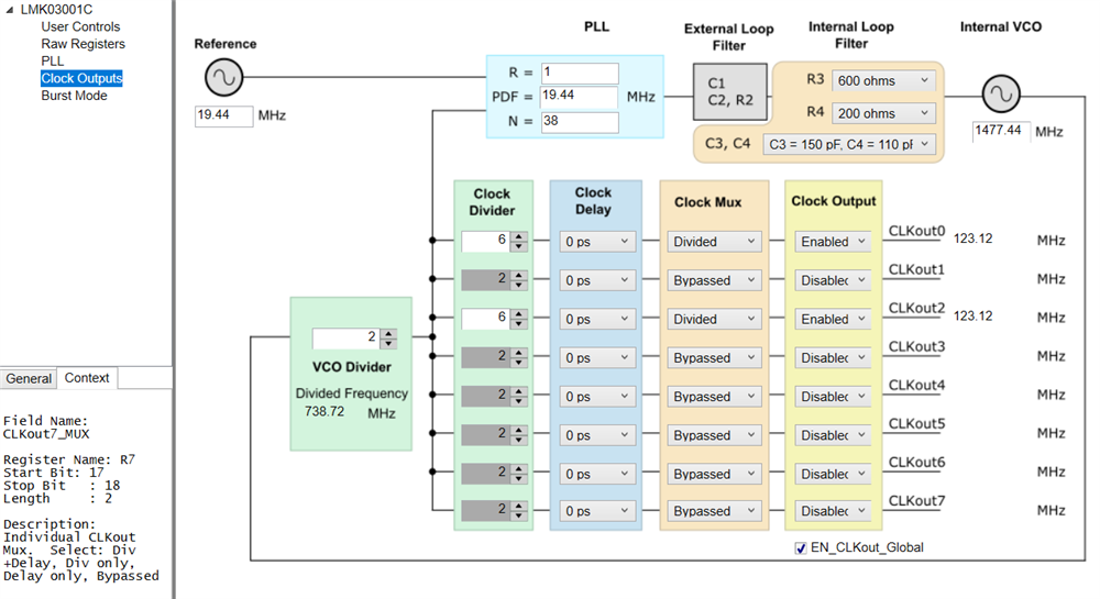

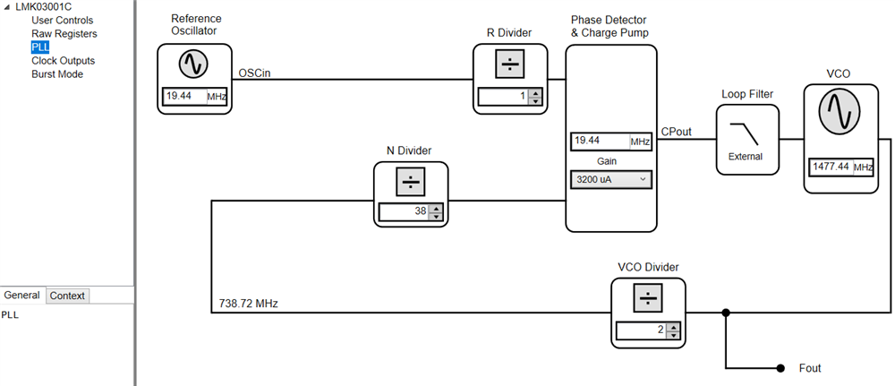

Our customers are evaluating performance on EVM and TCS Pro but are not getting the correct output frequency.
I think the register settings are correct, but could you please check the settings below?

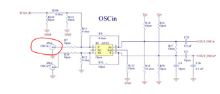

OSC is 19.44MHz on the board.
Our customer setting is 123.12MHz, but the measurement result is 113.7MHz.
And the boards they designed have similar errors.
