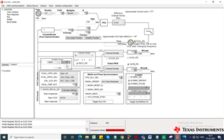

I am using the LMX2595 to generate the output frequency within the range of 1.3GHz to 2.4GHz. But observed spurious at 50KHz offset I tried for 1.4GHz and 2GHz output frequency also changed the power supply and checked same spurious are present. The measured results and schematic is attached. Please suggest how to remove this spurious.

  • Hi Sushant,
    Could you provide your PLL configuration in TICS Pro format?
  • As requested please find the attached TICS pro setup image and register values.

  • Hello Sushant,
    For diagnostic purposes, if you set the PLL in integer mode and reload the registers, does this remove the 50kHz spur? If so, the spur is related to the MASH order or the fractional divider.
    Also, have you double-checked that the spur is not coming from your reference? You did mention changing the power supply without improvement, but I don't see anywhere that you checked the reference.
    Derek Payne
  • As per suggestion, I have tried changing the 100MHz REF but the same issue. 100MHz reference is taken from OCXO and there is no spurious from OCXO.

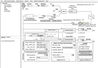

    Changed PLL in to integer mode but spurious is increased attached image of the spectrum and TICS Pro configuration.
  • Hi Sushant,
    I don't know what was happening, let's guess.
    Can you change the DC-blocking capacitors at the OSCin pins from 1µF to 0.1µF?
    Can you also try enable OSCin doubler and then make Pre-R divider = div/2?
    50KHz offset spurious looks like generating from the spectrum analyzer. So ignore these spurious.
    I am using this PLL to work from 1300 to 2400MHz frequency band with 1MHz step size I have done the PLL setting as following TICS Pro screenshot, Other than multiplier registers all other registers are kept constant. As per the required output frequency, we are changing multiplier register values. For integer frequencies like 1400MHz there is no spurious observed but for fractional-order frequencies like 1402MHz spurious with 2MHz offset 49dBc is observed.
    Spurious issues for fractional multiplier values as follow,
    Please suggest how to improve this spurious to 70 to 80dBc.
  • Hi Sushant,
    Please try:
    - make CAL_CLK_DIV = Div2.
    - use a smaller charge pump current
    - use third order loop filter
    - reduce reference clock signal swing
    - set PLL_DEN to something like 2345678 instead of integer multiple of 100
