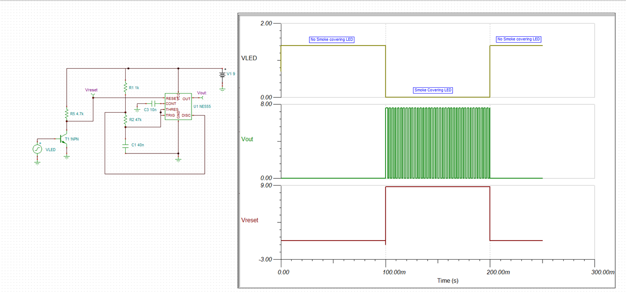

I am having some trouble understanding how this smoke detector circuit using the NE555 works.
Source: https://www.elprocus.com/smoke-detector-circuit-using-ic-555-timer/

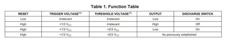

1. I don't know enough about smoke and phototransistors - does the smoke completely block the light from the LED (causing the signal to be steady), or does it only partially block the light (causing a more PWM-like signal)?

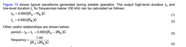

2. Are we driving the speaker by rapidly toggling the output, p3? i.e. quickly toggling between two of the conditions (one that causes output to go low, one that causes output to go high) in Table 1 from the NE555 Datasheet, or is something else going on?
