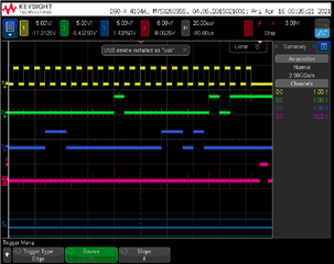

  • I've also checked very carefully the pin maps of the two connectors.
    I can verify that we received a good signal of SPI-Uwire at the connector PMOD on the board at the pin that we want.
    However, we could not see any signal at the 14 outputs clock of LMK03806.
    I think we need to debug the board before posting it here maybe someday for sure. ;)
  • This is the capture of signal SPI-uwrie at the connector in my board
  • Hello Van-dung PHAM,
    Those look like some really nice signals I presume the correct signal is on the correct pin.  For example clock on clock, etc.
    At start up without any program you should see a clock at CLKout8 and OSCout0.  OSCout0 should be a buffered copy of the OSCin and CLKout8 should be nominally 98 MHz.
    If you don't see those clocks, then there's probably something very fundamental wrong.
    73,
    Timothy

  • Thank
    I got this result from your help.
    It looks good for me in terms of VOD (≈400mV) and frequency (10 MHz)
    However, all of the clock outputs had not in the same phase.
    In my application, I would like to have all of the 14 outputs clocks have the same phase and frequency.
    Maybe I skip one of the important parameters in TICS PRO?
