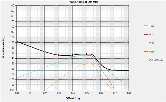

I am using LMK03806 in my design. Design details are as below
FOSCin = 10 MHz
Output frequency to be generated = 204 MHz
I am planning to go with Fvco = 2448 MHz.
Kindly suggest the PLL divider values for the best performance.
Also, elucidate the impact of Phase detector frequency in the overall jitter performance.
