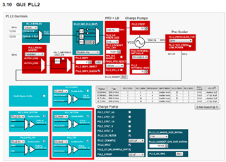

I have been facing an issue with the use of the LMK04610.
I am using the LMK04610 on both the LMK04610 evaluation board and a specific board.
The aim is to configure some outputs in order to generate specific clock frequency (e.g. : 104MHz) while bypassing both PLLs to keep phase noise as low as possible, but we also would like to be able to generate SYSREF pulses on SPI programming. Since the SYSREF_REQ also is clocked by PLL clock, it's not possible to use bypass mode (Clock Distribution Mode).
Thus we choose to configure the LMK04610 device in Single loop PLL2 operating mode (ref = CLKINx, Oscout =PLL2_output) while also enabling PLL2_CLKin to OUTCHX.
We tested this configuration on the LMK04610 evaluation board with TICS PRO software with the following settings:
• PLL2 settings
o CLKin0 = 624MHz,
o PLL2_RDIV = 6
o PLL2 PD = 104MHz < 250Mhz
o PLL2 OSC = 5928Mhz (VCO frequency range : 5870 MHz to 6175 MHz)
o PLL2_PRESCALER = 3
o PLL2_NDIV = 19
o PLL2 CLKOUT0=CLKOUT1=5928/6= 1976MHz
• CHANNELS/OUTPUTS
CLK outputs
o 16 bit CHANNEL DIVIDER = 6=> 624/6= 104MHz
o CHx_SYSREF_REQ/SYSREF_EN=0, SYNC_EN=1
SYSREF outputs
o 16 bit CHANNEL DIVIDER = 12=> 624/12=52MHz
o SYSREF Pulse counter = 1, CHx_SYSREF_REQ/SYSREF_EN=1, SYNC_EN=1
o PLL2_REF_DIGCLK_DIV = 32 ,
o PLL2 PD =104MHz/32=3.25Mhz < « sysref output frequency : 52MHz »
The problem is that the PLL2 isn't locked. As suggested in another thread : "Please note that it is not possible to trigger a SYSREF pulse in distribution mode unless a clock is present on the output of the PLL2 prescaler, implying a need to lock PLL2 (regardless of whether PLL2 is used)." Still, we seem to observe satisfying results.
What do you think about this configuration? Could we use this settings even if the PLL2 isn't properly locked?
We tested the same setup on our specific board, we obtained the same results except that after 1 sysref pulse generation the GLOBAL_SYSREF bit is stuck at 1.
According to the datasheet, the GLOBAL_SYSREF bit is cleared automatically after fulfilling the SYSREF request (self clearing bit). When we try to rewrite GLOBAL_SYSREF to 0 it doesn't work either.
Global sysref being at 1, we can no more trigger sysref pulse. This problem doesn't happen with the evalboard.
Here is a copy of the register programming.
Could you please provide us some support and let us know what we are missing?

  • Hello Philippe,
    So do I understand on the Operating Modes page, you pressed "Single Loop PLL2" (red or green button).  Then Bypass1 (green) or Bypass 2B (blue) button?
    I think you are on the right path.  However I don't think there is a reason to settle for PLL2 not locking properly, so we should identify and correct the issue.

  • Hello Timothy,
    Thank you for your quick reply.
    Not exactly. We followed the LMK04610 Evaluation board guide and choose in the GUI: Operating Modes tab, the Single loop PLL2 operating mode (green ref = CLKINx, Oscout =PLL2_output). Then in the GUI : PLL2 controls tab we changed the settings for PLL2_BOTTOM and PLL2_TOP to CLKin.
    Are you satisfied with the phase noise performance of the buffered outputs?
    Yes. When the PLL1 and PLL2 are bypassed, the phase noise meets our performances specifications.
    Do you happen to have the .TCS file from TICS Pro you could attach?
    Please find below a copy of the .TCS file used.
    conf_624MHz.tcs
    If we need to attempt re-production of this issue, is next week acceptable?
    Yes, it's not urgent as we won't focus our effort on this subject next week. You could have a certain amount of time and leeway if you need to reproduce the issue. I will wait for your investigations and results.
    Philippe

  • Hello Philippe,
    it is ok that PLL2 is not locked for SYSREF generation. But it should be locked.
    Before enabling the bypass mode, does the PLL2 lock in this state?
    Julian

    I don't know if the thread is still active. Thanks for your help concerning the unlocked PLL2.
    The PLL2 isn't locked before enabling the bypass mode.
    Were you able to re-produce the issue? Is there any other test we could do?
    Since we are able to generate sysref, it isn't a blocking problem on our part.
    Also, I would like to ask for your help concerning the second problem described :
