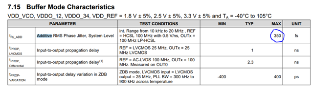

Do Out0 and other clocks derived directly from refclk have a jitter measurement?
Do the dividers preserve any jitter spec when the PLL is powered down and use refclk?
