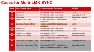

  • Hi Timothy,
    Thanks for the reply, I shall consider even-odd pairs for your device clocks & SYSREF.
    we are following the below methodology for multi-LMK sync (2b), Ref Freq = Sysref Freq
    Also Synchronization method as Zero Delay Mode, wherein ZDM rule is met, I do not need pulsed SYSREF to occur at the same time for both devices, using Dual loop mode with low Freq to PLL1
    After the above considerations, will my scheme is fine?
    NOTE: I do not want to use any Master/root LMK, neither I have a plan/scheme/option of using SYNC/CLKIN0 for sync purposes.
  • Hello Shekhar,
    As you mention - if SYSREF doesn't have to occur at the same moment on multiple boards, then it is easy and your scheme is fine.  I agree no need for a root LMK.
    73,
    Timothy

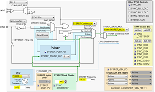

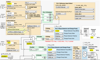

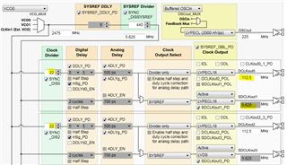

    Modified Requirement
    1] DCLK = 112.5MHz (Use internal RFSoC PLL to get 1350MHz)
    2] SDCLK = 5.625MHz (Integer multiple of sampling CLK/16 i.e. 1350/16 = 84.375)
    Now for this, we are using the below settings in TICS Pro
    1. Input CLKIN0 is configured as 5.625MHz
    2. The PLL1 phase detector is also configured as 5.625MHz
    3. External VCO is chosen as 225MHz
    4. The internal VCXO should be in the range of (2370 - 2630)MHz or (2920 - 3080MHz)MHz
    5. The VCXO mux is configured as VCO0 as the frequency which has chosen is 2475MHz, 2475MHz is chosen because 2475/440 gives us 5.625MHz as the sys ref frequency
    6. The feedback path is chosen as FB_MUX which eventually is SYSREF (Nested 0 Delay F/B)
    1. SYSREF clock divider is chosen as 440 to get SYSREF Frequency as 5.625MHz
    2. SYSREF_MUX is chosen as SYSREF continuous
    3. SYSREF_CLKin0_mux is chosen as from SYSREF_MUX
    4. From this configuration, we get the SYSREF_Frequency
    1. DCLKs are used to generate high frequency, and SDCLK are used to generate low frequency
    2. DCLK frequencies can be generated only through Internal VCXO Divider and SDCLK frequencies can be generated as SYSREF Frequency
    3. As the SYS_REF we require is the same as the SYS_REF generated, it doesn't need to pass through any dividers, the clock output selection can be made SYSREF as shown.
    4. Clock divider value is chosen as 22 to get 112.5MHz
    Please Validate the scheme and suggest changes if any...
    Shekhar
  • Hello Shekhar,
    Were/are you able to test this on your board and system to determine if it meets your requirements?  At the end of the day you'll need to confirm everything as you need performance wise, etc.  For example, any possible spurs because of running SYSREF in continuous mode.  Observe there is no separation between DCLKoutX and SDCLKoutY.
    I think you mean external VCXO frequency is chosen as 225 MHz.  It's ok if really it is an external VCO so long as you are satisfied with the performance.
    Internally we have VCOs.
    There is no internal VCXO divider.  Perhaps you are referring to the channel dividers from the VCO?  Both the device clock and SYSREF are generated from the dividers from VCO in this configuration.  This is ok.
    Everything appears selected properly.  However the SYSREF is produced by the SYSREF divider from the VCO.
    73,
    Timothy

    I am using below configuration
    CLKIN1 = 5MHz
    PDF1 = 0.625MHz
    VCXO = 225MHz
    PDF1 = 112.5MHz
    VCO0 = 2475MHz
    FB_MUX = SYSREF_DIV
    PLL1 N CLK MUX = FB_MUX

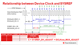

  • Shekhar,
    This looks fine to me.
    I've attached a slide image below that helps to configure the digital delays for each of the output clocks and the SYSREF to ensure the alignment is as desired. You can use this slide image and the equations and tables it includes to compute the required DCLKoutX_DDLY_CNTH, DCLKoutX_DDLY_CNTL, SYSREF_DDLY, and SDCLKoutY_DDLY, based on the required SYSREF_DIV and DCLKoutX_MUX values.
    In your case, SYSREF_DIV = 440, and DCLKoutX_DIV = 22, so DCC + HS is unnecessary. Thus, SYSREF_DIV_ADJUST = 2, DCLKout_MUX_ADJUST=1, and C = 3.
    A valid combination to align the device clock and the SYSREF would be:
    [edit: I messed up originally, see revised values below]
    DCLKoutX_DDLY_CNTH = 7
    DCLKOUTx_DDLY_CNTL = 6
    SDCLKoutY_DDLY = 1 (2 cycles)
    To align SYSREF_DDLY such that the SYSREF is at the same time as the rising edge of the device clock:
    [edit: I messed up originally, see revised equation below]
    SYSREF_DDLY = DCLKoutX_DDLY_CNTH + DCLKoutX_DDLY_CNTL - (C + SDCLKoutY_DDLY (cycles)) = 7 + 6 - (3 + 2) = 8
    If you wanted to align to the falling edge, since 2475/112.5 = 22, you could add 22/2 = 11 to SYSREF_DDLY to force alignment to the falling edge instead. The new SYSREF_DDLY value would be 8 + 11 = 19. This should make it clear how to set the SYSREF phase with respect to the device clock phase.

    • Multi-Device System
      • Case1: Not a requirement
      • Case2: Input-Output Phase Determinism
        • Work LMK in Nested Zero-Delay Dual-Loop Mode
        • Follow both the rules of ZDM
          • Input Clock = SYSREF
            • If the input clock is a multiple of the SYSREF, N/R is not an integer
              • Then I have multiple phase relationship b/w input and output
                • I will use reset R-divider (LMK04832) which will match with one phase w.r.t. input (Phase Certainty)
                  • Should this reset be used at once together across all Devices?
          • SYSREF DIV as feedback
        • GCD(outputs) = SYSREF, all device clocks can share an edge with the SYSREF edge
          • But mandate to use the "SYNC DIVIDERS" feature of TICS PRO
            • This will stop all SYNC inputs, set normal SYNC mode, enable all dividers for SYNC, issue a SYNC by

    The digital delays for DCLK and SCLK determine the number of VCO cycles after the SYNC event that will be swallowed before the clock begins. It is not correct that performing the "SYNC Dividers" function in TICS Pro will automatically guarantee device clock to SYSREF alignment. It is more accurate to say: there always exists settings for the DCLK/SCLK digital delays and global SYSREF delay, which ensure that device clocks and SYSREFs share an edge after a SYNC event. But the settings for digital delay are different for different divide values, and must be calculated beforehand. Default digital delay values are usually incorrect, because default digital delay values are selected for default divider values. Additionally, you don't always want device clocks and SYSREFs to share an edge; for instance, in many systems, the setup and hold window for SYSREF centers around the falling edge of the device clock instead.
    Datasheet section 8.3.5 SYSREF to Device Clock Alignment gives an equation which can be used to pre-compute the SYSREF to Device Clock Alignment for any given device clock, using the DCLK/SYSREF divider values, the duty cycle correction for the DCLK, and the digital delays.

      1. For output divider SYNC, SYSREF_MUX is set to 1 (re-timed SYSREF).
      2. The SYSREF distribution path is also the SYNC path. The output of the SYSREF_MUX can be used as the internal divider reset signal. There are some bits, SYNC_DISx and SYNC_DISSYSREF, which gate the SYSREF distribution path to the divider reset for each channel. If these bits are set, the divider reset is gated and the SYSREF distribution path signal does not reset the divider. If these bits are cleared, the divider reset is ungated and the SYSREF distribution path signal will reset the divider on a HIGH signal.
      3. There's two components to a SYSREF reset:
        1. The main SYSREF divider functions just like a bigger output divider: it can be reset by the signal out of the SYSREF distribution path and the reset is gated by SYNC_DISSYSREF bit. If you are following the ZDM rules, there is no need to ever reset the SYSREF divider, because the SYSREF divider is always in phase across all devices. But when you need to set the phase of a single device, irrespective of input clock, you can reset the SYSREF divider so that both CLKOUT and SYSREF phases are reset.
        2. The local SCLKX_Y_DDLY is reset by setting SYSREF_CLR=1 for at least 15 VCO cycles. Incidentally, you could write SPI to the device at the maximum speed merely toggling SYSREF_CLR state 0->1->0 and this should always be sufficient for clearing SCLKX_Y_DDLY state.
      4. I have included two diagrams below: one clarifies the path when performing the SYNC and setting SYNC_DISx=0; one clarifies the path when enabling the SYSREF divider for continuous operation (as an example, could also be pulsed or some other value), with SYNC_DISx=1.
    SYNC path, assuming SYNC pin or SYNC_POL toggle, using SYSREF_MUX = re-timed SYSREF divider while following ZDM rules:
    SYSREF path, after synchronization is complete, using SYSREF_MUX = continuous SYSREF:
