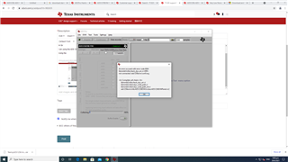

Hi Sir
I am using the ADS 1256 module connected with SPI port.
Using the ADS1256 the ACD pro has error as "EVM/HW Incompatible"
Please advice .
Thanks and regards
Thiagu

Hi Thiagu,
You might try following the recommendations in this e2e post: https://e2e.ti.com/support/data-converters-group/data-converters/f/data-converters-forum/990633/ads1256evm-pdk-inquiry
The second recommendation about the EEPROM file would be the easiest to try so it would make sense to start troubleshooting with that.
