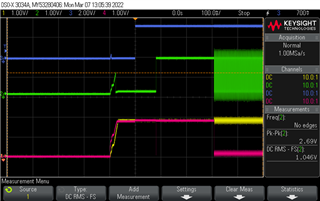

  • We also did the same experiment on ADS4245 Eval board and found same issues.
    1. Blue is 1.8 VDD, yellow is ADS B2 (which is pulled high externally) and the green is CTL1
    CTL2 and CTL3 are connected to GND using jumpers on EVAL board. As you can see that despite of ADS B2 being pulled high externally, it gets pulled low during ADS power up in Global power down mode. So, it seems ADS4245 for some reason, is pulling output lines during this mode of operation.
    -Pawan

  • Hi Rob,
    Yes. That is what we saw except for evaluation board we have the particular pin which is suppose to read high (logic 1) was pulled low (logic 0) instead of being noisy.
    Pawan
  • Hi Pawan,
    We checked the EVM and we do not see any output noise on the output data bits. The outputs are logic low when the power down is initiated with either the control line approach or the ADC GUI.
