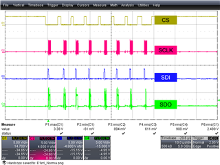

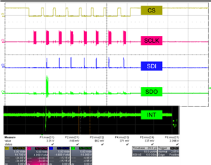

We are using SPI communication between the TMS320F28377D and the TLV2548-EP chip. At room temperature (approximately 20°C), the ADC is sensing signals correctly. However, when the temperature drops to around -30°C, the TLV2548 chip stops sensing signals and produces the waveform shown below:
*communicating using the following timing
1. Normal operation - room temperature(20°C)
2. Malfunction - low temperature( -30°C)
When we operate the system from room temperature to low temperature, all other functions of the DSP and the device remain operational, except for the sensing function of the TLV2548. However, when we operate the system from low temperature to room temperature, the TLV2548 does not automatically recover from the malfunctioning state. We need to turn the power off and on again to make it operate normally.

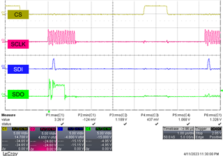

    Can you also zoom in on the scope captures (room and cold) so that we can see the relationship of SCLK to SDI and SDO?
    1) ROOM
    2) COLD
    Thank you for your response.
  • Can you zoom in a little closer?  The SDI dv/dt seems to be slower at cold, I'm trying to see if the communication is correct.  You have a long period of /CS low, can you slow down the SCLK a bit and see if that helps?
  • Thank you for your response.
    Upon checking, it seems that the voltage level of the pin inputting to the 28377 SPI communication is not 3.3V but 4.2V, which may have caused the malfunction. However, I am not sure why the problem only occurs at low temperatures and works normally at room temperature. For now, we have decided to modify the hardware to solve this issue. Thank you again.
