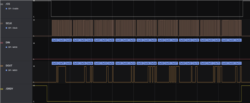

  • Hi Dale,
    I had requested for friendship to share my schematic. Please do accept it.
    Mean time I am sharing you the results for reading clock register after powering-up the ADC. Would you review and let me know?
    Below image indicates the 2 frames data (between first blue marker to yellow marker). Second blue marker is the start of second frame.
    The below image is for sending write command to read clock register.
    This image shows the event occurring on DOUT line in between dummy clocks before completion of the frame.
    The above images are captured with SCLK = Fclk/2. And it is being observed same with SCLK = 20 MHz. The response is not as expected I feel. Please do let me know the reason for it.
    Prakash

  • Hi Prakash,
    Did you keep /CS always low?
    Below the right timing to read CLOCK register, note that you can just send RREG command with 24 SCLKs in the 1st frame and you can see the register data (0xFF0E) in 2nd frame by sending another 24 SCLKs, there is no need to send 9*24 SCLKs in a frame for reading a register:
    The 2nd timing below is writing CFG register with WREG command:
    The 3rd timing below is reading data for all channels, the data on DOUT:  Status register+CH1 data+CH2 data...+CH8 data:
    I hope these timings can help you understand.
    Your schematic looks good, but you do not have common-mode capacitors on inputs and also I do not know your purpose to use two 1kohm resistors between AINxP and AINxN.
    Dale
  • Hi Dale,
    Thanks for the response.
    Good news...... I am glad that my code is working. The changes I made are:
    1. After RST de-assertion I started writing to the registers directly instead of disabling the channels.
    2. In earlier code I was writing the registers one after another with full command (e.g. {WREG_CMD, CLOCK_REG_ADDR, 7'd0, CLOCK_REG, 8'd0} = 48 bits) having some delay in between and with /CS low. It didn't work. Now, I modified as send write command for writing 4 registers (24 bits) and after few clocks of gap register value (24 bits) one after another with few clocks of gap in between and kept /CS low.
    But why it didn't work earlier I am unable to make out. If you any idea let me know.

  • Hi Prakash,
    Your full command for writing a register to M08 ADC is incorrect. Since your word size is 24-bit, so you have to send your both WREG command and data in 24-bit format. Your total WREG command+data should be:
    • 1st 24-bit word:   (WREG_CMD) + (CLOCK_REG_ADDR) + (7*'0' for single register write) + (8*'0') = (011b)+(000011b)+(0000000b)+(00000000b)
    • 2nd 24-bit word:  (CLOCK_REG) + (8*'0'} = (16-bit register data) + (00000000b)
    You can have a delay between these two words, like one SCLK delay in my WREG timing example I showed to you above, or there is no problem to send out all 48-bit data to the ADC if there is no delays between the words. I strongly recommended you to see my timing examples above.
    Toggle between the words: you can write your registers one by one by toggling the /CS signal for each frame, or you can write multiple registers in a same frame by keeping the /CS low until all register data are sent out, see the timing in the figure 8-25 in the page 45 of the M08 datasheet. Note that the 'nnn nnnn' in your WREG command should match the quantity of the register in your frame of both solutions.
