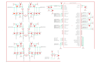

I'm trying to program the DAC8775. I followed the setup guide exactly like Brian did, but I ended up with an output of 0V, with a lot of noise.
Status Register returns meaningful values and when I write in register 0x02 on bit UBT, I receive a response on bit UTGL of the Status Register.
But when I set Buck-Boost Converter as +-15V, bit PGA, PGB and PGC (I'm using only the first 3 DAC channels) are 0. Instead, if I set PNSEL bits as 10 (positive arm disabled, negative arm enabled) Status Register's bits are 1.
On Status Register, bits FC, FB and FA are never 1, so it makes me think that the DAC output is ok. But, as I told before, it is not.
Here is the schematic of Buck-Boost Converters:
I really hope you can help me.

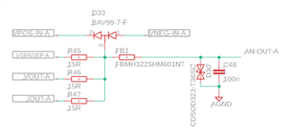

    Output schematic:
  • Matteo,
    I would start measuring nodes around your board to make sure the device is coming up the way you expect. When you enable the reference, can you measure the 5V?
    I would start by enabling the positive and negative supplies and measuring them. What voltages do you see before and after enabling them? After that, I would set the DAC range, and then enabling the DAC. If you're in voltage output mode, you would likely see the VPOS_IN_x and VNEG_IN_x voltage set automatically to ±15V.
    If you are able, I do recommend getting a DAC8775EVM and using that to check settings of the device. Regardless, you can use a multimeter and check the voltages as you bring up the board. Let me know what values you see.

    I measured VPOS_IN_x and VNEG_IN_x before setting it using register oxo6 and 0x07 and it was something like 150mV. Then I enabled BBc on every DAC channel and set it to ±15V, I can measure -15V on the negative arm but I can't measure +15V on the positive one, just as Status Register refers.

    To me, it looks like something is clamping the VPOS_IN_x close to ground. I haven't completely looked over your schematic, but you should compare the buck-boost section to the same schematic in the DAC8775EVM user's guide. Do you have a diode reversed someplace to accidentally clamp the VPOS_IN_x to ground?
