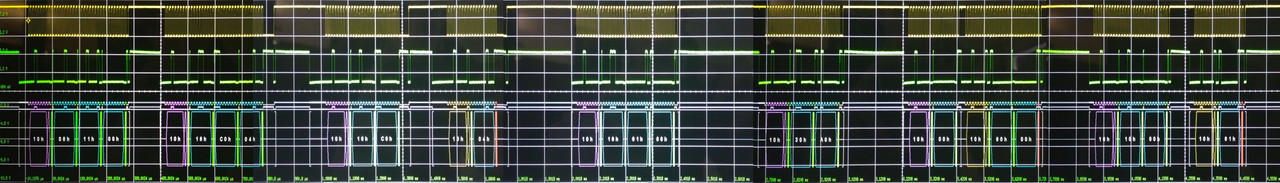

  • Hi Joe.
    Here are photos (combined together for better clarity) of the analyzer of "one cycle" of the program, which do this:
    - manual selection of channel 0 (set value 0 to CHANNEL_SEL register)
    - set bit RMS_DC_SUB in RMS_CFG register
    - read RMS_CFG back to check it's written correctly
    - enable RMS by set bit RMS_EN in GENERAL_CFG register
    - read recent data ADC measurement as 2 words (this returns 128, 0 values, as I don't have anything connected now to the input, so the voltage is in the middle)
    - read SYSTEM_STATUS register to check the RMS_DONE bit

  • Hi Daniel,
    I think the reason why you never see the RMS_DONE bit get set is because, when in manual mode, you need to manually take all the conversions required for the RMS calculation. Setting the CNVST alone does not accomplish collection of all the samples required for the RMS calculation.
    Bob does a great job of detailing this in the forum post below (see the table towards the bottom). You also have the option of using the device in autonomous mode, which might be easier to accomplish rather than manually collecting all the samples necessary.
    https://e2e.ti.com/support/data-converters-group/data-converters/f/data-converters-forum/1194057/ads7128-rms-module-not-working-as-expected
    Let me know if implementing that sequence gets you good results, and feel free to reach back out for more clarification.
    Joel

  • I maybe found a weird thing.
    When I try to clear BOR bit in SYSTEM_STATUS, it's very hard to read it back as 0.
    And even when I read it back as 0 and I try to read it again, it changes back to 1 immediately.
    I checked the voltage with oscilloscope. There is some rush on MHz frequency.
    But it doesn't make a lot of sense, because If the ADC really restarted in this way, then theoretically there could never be even a successful RMS measurement on a single channel...
    I made now a very dirty way, that I restart whole ADC (using RST bit) between each measuring and set it whole again.
    It's not a good way, but I'm able to get the RMS value on the 3 channels.

  • Hi Joel.
    Sorry for late response.
    We use 1uF ceramic capacitors, as recommended in the datasheet.
    I check the voltage with oscilloscope and it looks OK for me.
    3.3V digital, this voltage is more rush, but in range of +-40mV
    3V analog. This voltage is regulated from the 3.3V digital and is much smoother. Sometimes there are the peaks of +-20mV with length of around 150us, which I don't think should be a problem.
    Also I don't think that the BOR really occurs, because otherwise I wouldn't be able to measure any RMS at all...
    Also the problem with clearing the bit in STATUS register I have also with the RMS_DONE bit.
    This is I2C capture for BOR bit clear:
