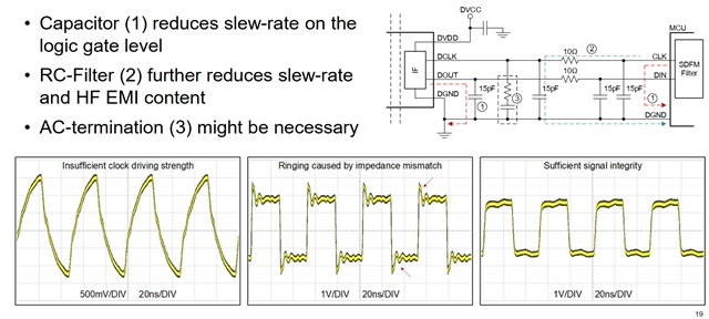

    If you have a problem with the CRC when you enable the PWM the problem is likely in the signal integrity of the SPI interface. In general, I recommend adding a 10 ohm resistor on SPI lines and 15pF capacitor on both ends of the signal trace.

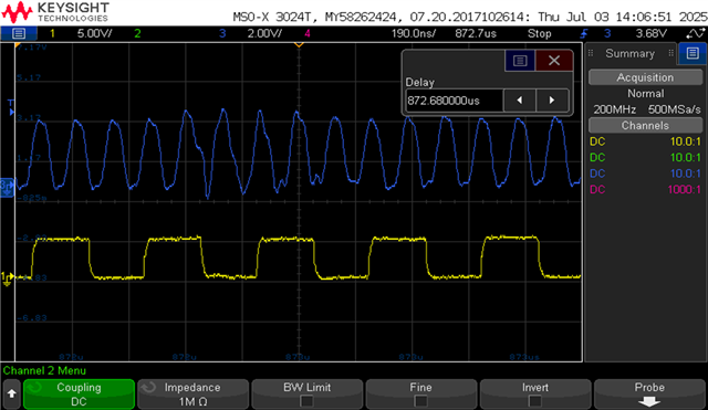

    Please also make sure that the CLKIN signal  is clean without any reflections or glitches. Some microcontrollers are not able to drive the CLK signal fast enough. Below is an example of the CLK when the MCU is not able to drive a longer PCB trace with the capacitive loading.

    Here is an example for the very same signal with SN74LVC1G17:
    /resized-image/__size/320x240/__key/communityserver-discussions-components-files/73/pastedimage1749541706525v2.png
    Summary:
    • Add 10 ohm serial resistors with all digital signals (DIN, DOUT, CS, SCLK, CLKIN).
    • Place 15pF capacitors between the above mentioned signals and ground DGND. Do it as close to the MCU and AMC131 as possible
    • Make sure that the MCU can drive the CLKIN without too much distortion. Add an AC termination circuit if needed (100 ohm, 220pF).
    PS: Suggested values are rule of the thumb, you may still need to adjust the values to match the PCB design.
    Attached is a PDF with the key suggestions. I created this overview for isolated modulators but the logic and principles apply to AMC131M0x as well.

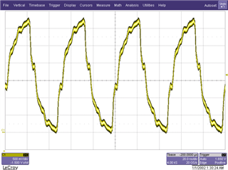

  • Hi Jiri thanks for your response.
    CLKIN U have mentioned is spi clk or osr CLKIN from mcu. since spi clk is fine only, my sampling CLKIN of 8mhz looks like a sinewave not as square wave.

  • Thanks for the clarification Srinath,
    regarding the CLKIN - I mean the clock for the delta-sigma modulator inside the AMC131M0x device, not the SPI clock.
    I personally assume that if the CLKIN signal looks more like a sineweave, it is not a a big problem as long as there is not any glitch around the logic level thresholds. The CLKIN input does not have any de-glitch filter.

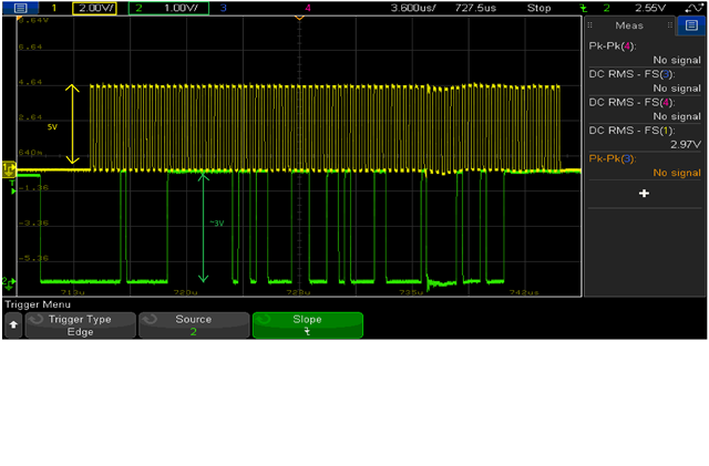

  • Dear Jiri,
    CRC ERROR FRAME.pdf
    Thanks for your reply. We are configuring ADC in 16-bit mode, 8 ksps, DC-DC enable. 10 bytes data that we are receiving is 0407 FF6C 38D0 C082 23FF. CRC is not matching. Waveforms of SPI clock and DOUT (MISO) is attached, captured right near the ADC. It looks data is received correctly on SPI bus. How can we move further? Looking for your help...

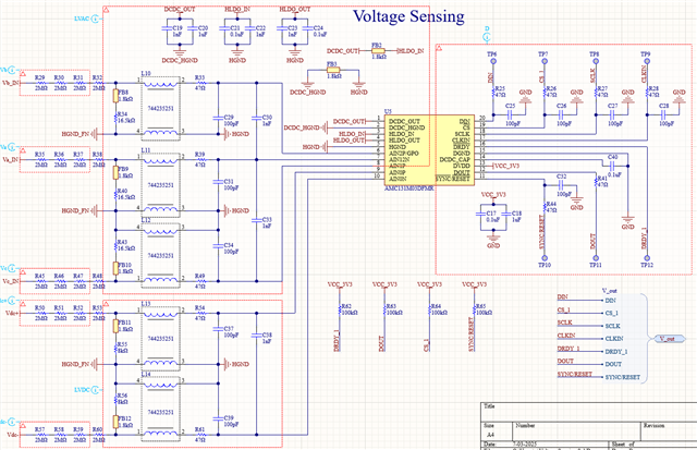

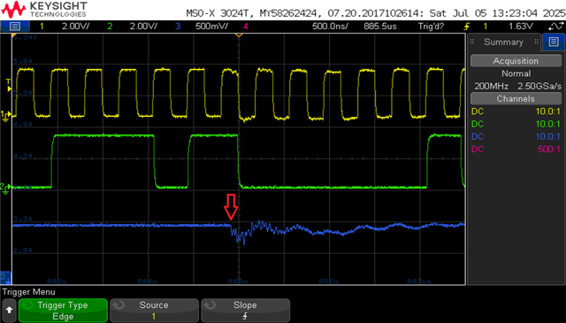

  • Dear Jiri,
    Some more information on this issue:
        - CLKIN signal captured and image is below
        - Schematics is below
        - ADC values are also not correct (corresponding to analog input) along with CRC when the CRC fail event occurs. Till now every time it is ADC channel 2 whose data is not correct. ADC0 and ADC1 looks good.
        - In MCU, DRDY is configured as high priority interrupt and the SPI frame is read with the help of DMA so that no other interrupt interrupts the 10 bytes SPI frame
    We have tried with different values of bypass capacitors on DVDD pin but the issue persists.
    Is there any circuitry in the device which is sensitive to DVDD voltage and causing device to partially reset? We have observed little oscillations on DVDD pin, can this be an issue? How to address this issue?
    Jitendra

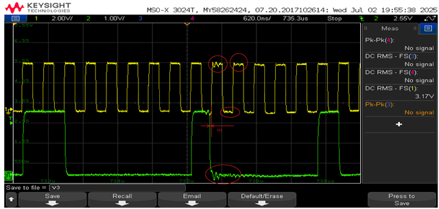

  • Dear Jitendra,
    first, thanks a lot for providing all the information. It does not happen every day that a customer asking for help provides clear and crisp data for analysis.
    I reviewed the material together with our digital engineer for the AMC13xM0x devices.
    Based on the content of your buffer, (0x0407, 0xFF6C, 0x38D0, 0xC082, + CRC ) we also came to the matching CRC 0x8A7F. This confirms that your firmware calculates data properly.
    However, we identified two things, that are not clear to us and may indicate the origin of the problem.
    1. You power the device from DVDD = 3.3V. When I look at the SPI waveforms, it seems that the host controller uses 5V logic levels. This means the SPI clock signal is overdriving the pin. The digital signals have to stay withing DVDD, DGND range. Otherwise, it may cause unexpected behavior as the internal protection cells (ESD) open, cause extra current, etc.
    2. The second problem is in the CH3 data transmission. Even when looking at the previous waveform, that represents the complete frame, there is some unexpected voltage drop in logic levels. When I look more into the CH3 waveoform, I see that there the DOUT pin changes the level unexpectedly. (this can be an ESD diode triggering).
      Our device changes the data (level) on the rising edge of the SPI clock coming from the SPI master. This is nicely visible in other DOUT changes, that the DOUT changes just couple nanoseconds after the rising edge of the SPI clock. However, in this example, the DOUT changes even before the edge comes. I assume that there is something wrong on the system level and this might be a result of the impulse noise. Could you also monitor the DVDD when this happens?

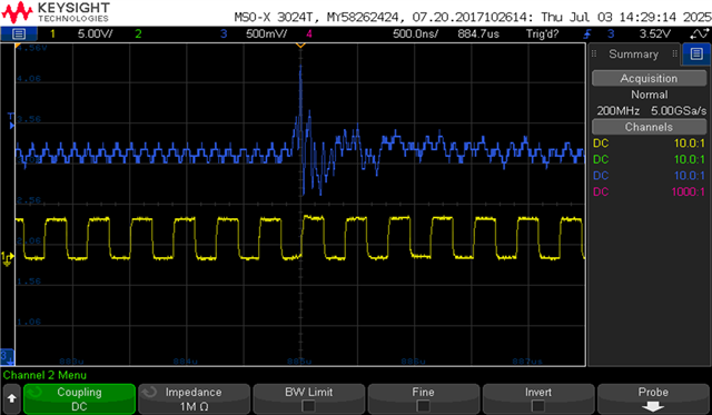

  • Hi Jiri,

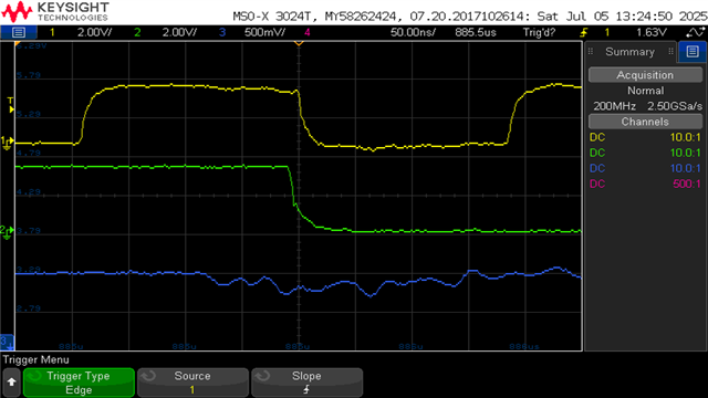

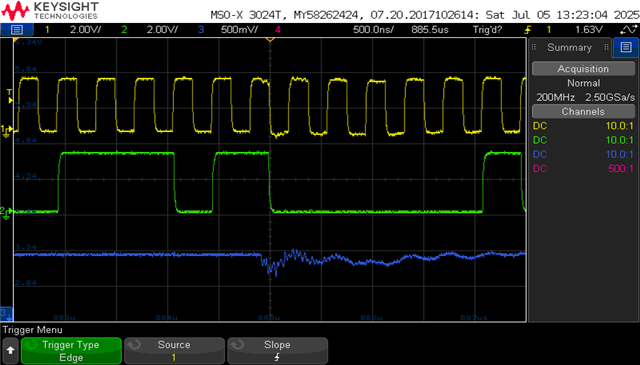

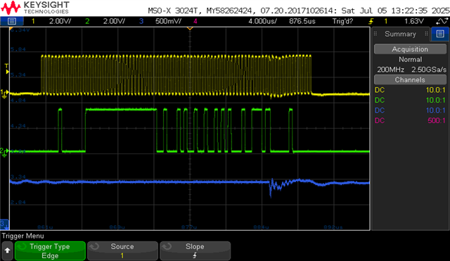

    Thanks for your suggestions. As suggested, SPI CLK voltage reduced from 5 to 3.3V. Still the problem persists. As required below is the DVDD capture.
    Does noise at sync/reset pin can cause the behavior that you identified in point 2?
    Jitendra
  • Hello Jitendra,
    do you have any explanation for what's happening with the power rail ? What starts the dip and the oscillations? This is a part of the waveform that concerns me the most.

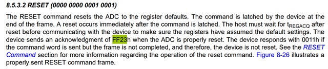

  • Well, I've been thinking about that and I think I have a theory and some answers to my own questions (please check).
    I believe that the device resets about the time I highlight with the arrow. The fact that last two bytes in your buffer are 0xFF and 0x23 are not a coincidence. The device sends 0xFF23 after the reset as mentioned in the device datasheet:
    Do you always get FF23 or 23FF when this happens?
    I bet the DC/DC converter remains disabled after you detect this CRC error.
    What is puzzling is the fact that you get 23FF instead of FF23. Nevertheless, you also operate in the 16b mode whereas most of our customers (and my own designs) use the 24b mode. Normally, after the successful reset, the device requires some time before the new communication can start. However, if the reset occurs during the SPI transmission, also the device internally reconfigures SPI from 16b to 24b frame. I can imagine that there is some garbage, or a race condition, that results in 23FF instead of FF23 due to this transition from 16b to 24b frame.
     It is now me wildly guessing but 0xFF and 0x23 are not a coincidence.

  • Hello Jiri,
        - Noise is coupling with power rail and we are looking into the possible root cause of this
        - We are running the power converter control based on the received ADC values. As soon as the CRC error occurs, we stop the control. We have not checked the output voltage of DC-DC in case of CRC error but subsequent frames return the status as 0x0407 which is same as the status received before CRC error. Chip select goes high and low again between each frame.
        - We will check the DC/DC converter voltage and let you know
        - 23FF or FF23 are consistent in CRC frames. CRC field varies and not same in case of error
        - We have RC filter on SYNC/RST and replaced C with high value of 100 nF and did not observe CRC error for sometime but this thing needs to be confirmed in full power conversion condition. Do you think that slight drop in the voltage of this pin can cause this issue?
