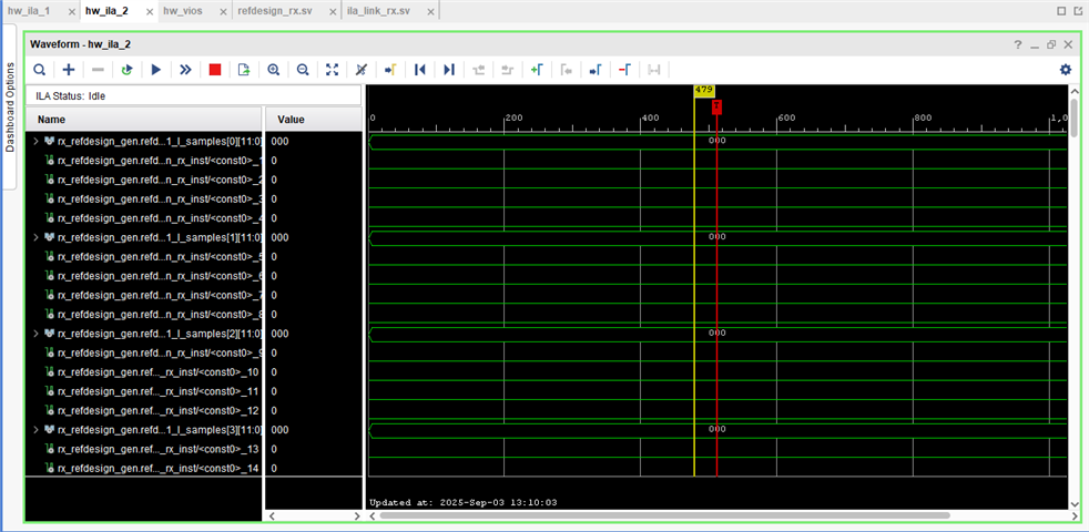

  • Hi  ,
    Update, I have since followed the 8.3 Initialization Set Up steps in the ADC12xJ1600 datasheet and then set the pattern mode. Yet in the ILA aside from the rx_sync_n signal which is always 1, I can only see rx_lemc_pulse pulses, as below.
    All other values, including from the data lanes, return as 0s. Any idea why this might be? Thank you.

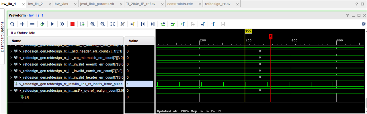

  • Hi
    I also made a copy of the project and did simulation loopback following steps here:
     https://e2e.ti.com/support/data-converters-group/data-converters/f/data-converters-forum/1230925/ti-jesd204-ip-simulation-of-loopback-design-in-vivado
    It all worked as expected, so I believe the FPGA design is fine? However, the equivalent Rx only project design does not see any data (only the lemc pulses) after I program the FPGA and configure the ADC. I double checked that the lane rates and FPGA reference clock match between the FPGA and the ADC.
    I have tried initializing the ADC in the GUI following the steps in chapter 3 of the ADCxxQJxx00 Evaluation Module User's Guide and also with the low level view following section 8.3 of the ADC12QJ1600 datasheet.
    But rx lane data valid does not go high and so I do not see any of the adc patterns. I would appreciate any advice on how to solve this, thank you.
