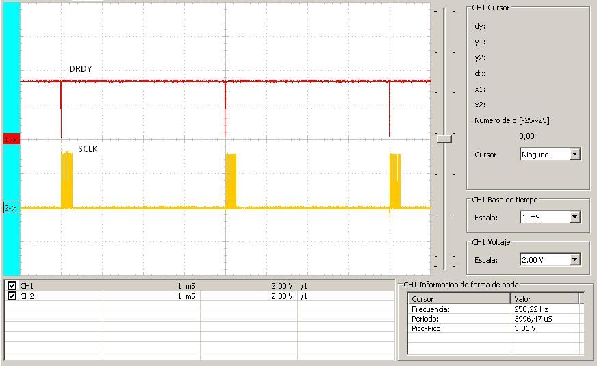

There you can see the data ready signal (red). i interrupt the micro in the falling edge. Below, the clock signal (yellow) from the SPI module.

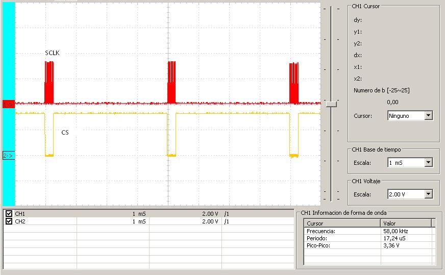

Here yo can see in red the clock signal and in yellow the chip select signal. I set it low duting the transmition.

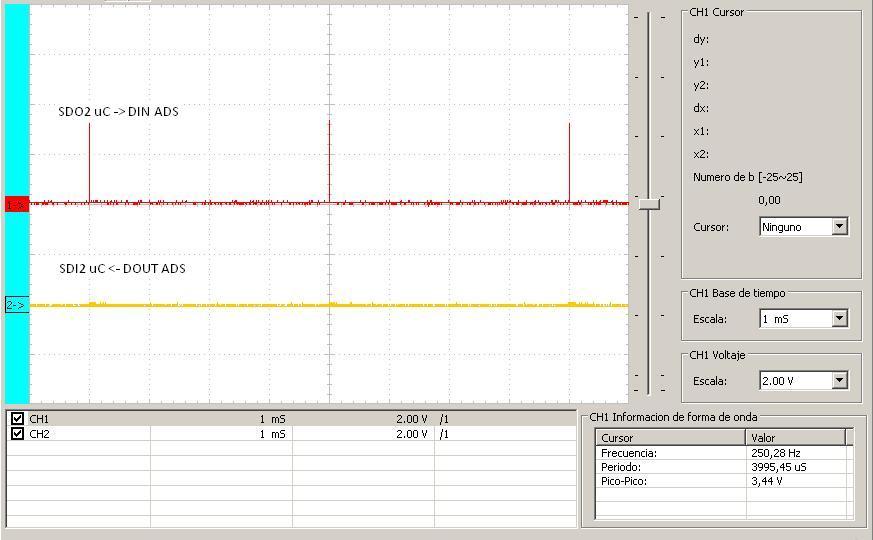

And finally the DIN (red) and DOUT (yellow). Nothing comes in nor out of the spi module.

    a general note: pease note that the CS/ does not totally disable the SPI interface of the ADS1298. So, the SPI bus is not a real bus. This only matters if you use more than one device at this bus. That said, note the minimum timing requirements, for instance the 17us you need to wait from pulling CS/ low to the first clock pulse. Maybe its better to keep CS/ low the whole time for testing.

  • Thak you very much for your answer. The problem i was getting was a hardware problem so thats why i was not getting any output but your observations were very good =). Now i held CS always low and i modified the configuration registers. Do you mean something like this:

    Do the registers configures even if there is something wrong with the DOUT line? I still can not see DOUT. I thought the problem was the hardware but i still not seen DOUT.
    Due the fact that I am seeing DRDY and the SPI clock, what else should I test? or what other configuration should I try?
    Thanks in advance!!
