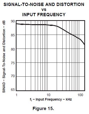

#1, SINAD at DC input
Our customer hope to know the SINAD at DC input to calculate ENOB at DC input. We know that the SINAD vs. Fin is provided at Fig.15 in datasheet, however it shows SINAD between 1kHz and 100kHz. So we would like to know the SINAD at DC as the reference information.

  • Hello Sonoki-san,
    SINAD, SNR, THD and SFDR are not defined for DC inputs. They are all measures of ADC dynamic range that apply only when the ADC input is an AC signal. Since ENOB is computed from SINAD, ENOB also applies to AC inputs only.
    The equivalent of ENOB for DC inputs is called "Effective Resolution", and Effective Resolution depends only on the ADC's intrinsic or transition noise that has a typical value of 1LSB according to the ADS8509 datasheet. Therefore the Effective Resolution for this device would have a typical value of 15 bits.
