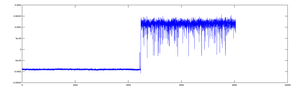

When I read at 61Hz (with a 1.000 MHz CLK), the noise is higher than 244Hz (4.000MHz).
Left part : data (in V) with a 4.000 MHz clock
Right part : data (in V) with a 1.000 MHz clock

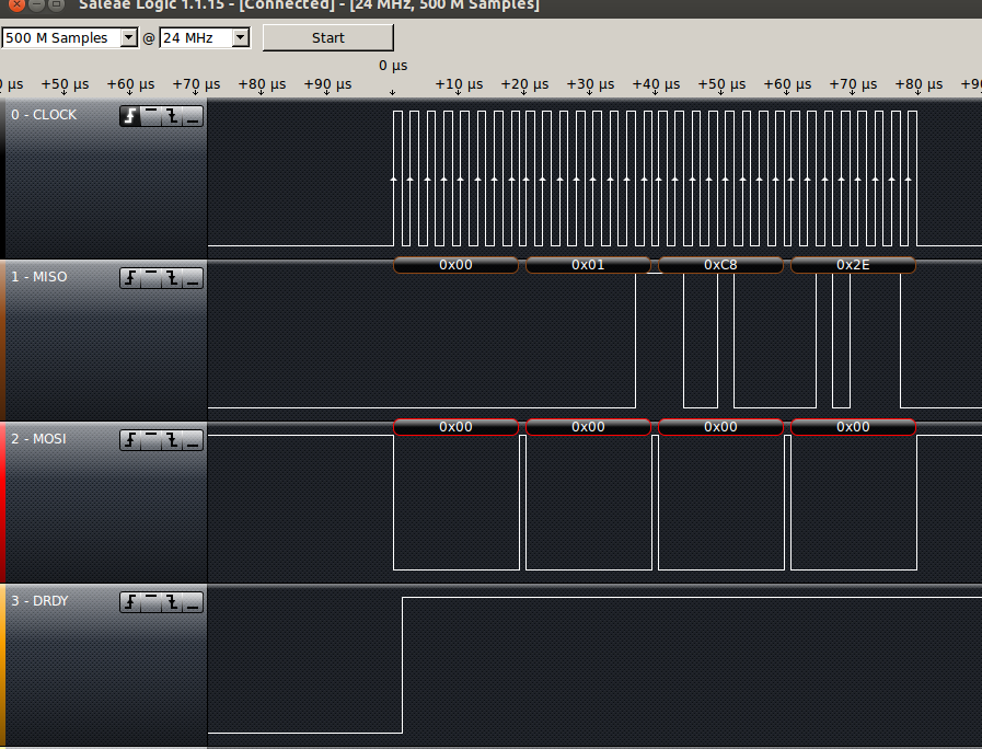

And the SPI communication seems good :
(SCLK = 400Khz)
Is there something wrong here ? I don't understand where is my mistake.

  • Hi Romain,
    Welcome to the TI E2E forums!
    The error may be occurring when you switch the CLK speed from 4.096 MHz to 1 MHz.
    You could have some glitches which are causing you to get out of sync with the ADS1281.
    I see that your conversion measurement switched from a negative result to a positive result and that the noise is very non-Gaussian!
    I'd expect the offset to change slightly, but it appears like something else is happening here.
    I would recommend toggling /RESET to reset the SPI interface (after switching the clock frequency) .
    Then reconfigure the device and restart the conversions to see if the "noise" goes away.
    Chris

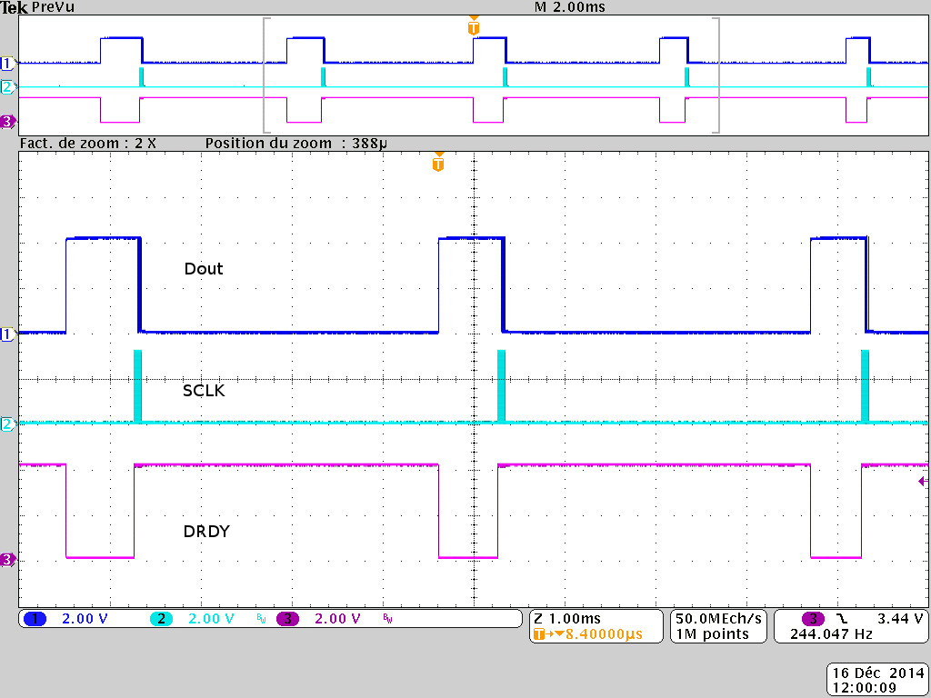

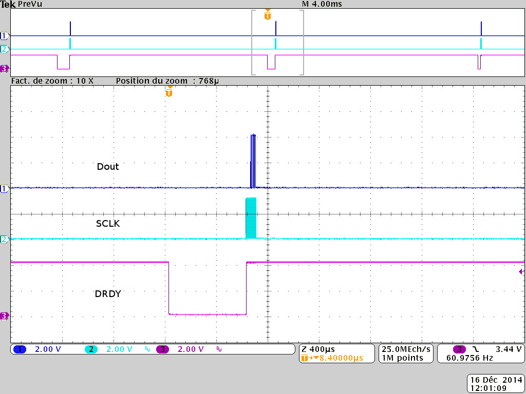

    But I notice a little difference :
    With 4MHz :
    With 1MHz:
    With 4MHz clock, the Dout pin goes high when DRDY goes low. Do we care about this ? Or is it a problem ?
    (Or is it just because the data is negative and start with 0xFF ? )

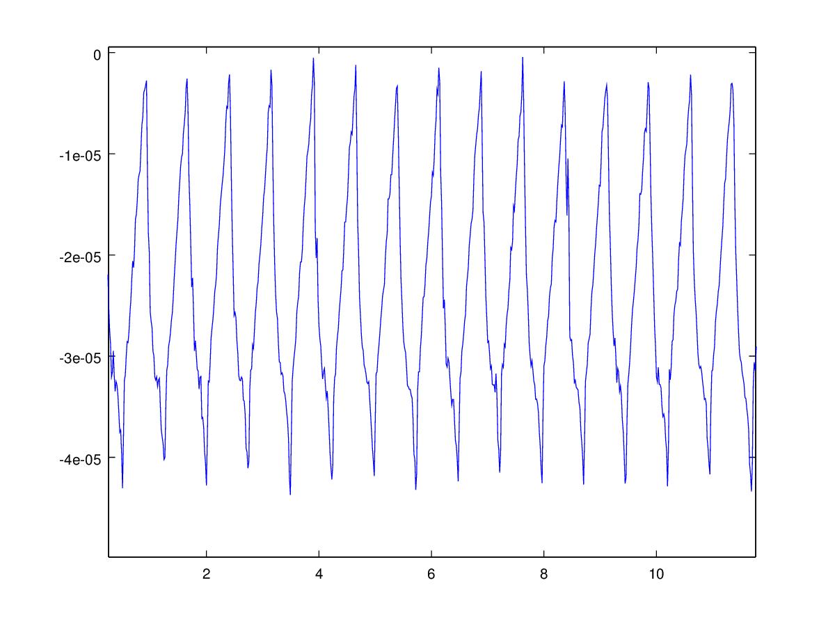

    EDIT:
    I just saw that my supply was a bit too high on the lasts results.
    I fixed it (and i hope the converter has not been damaged, but it still works properly at 4MHz).
    Now, with my 1MHz clock, this is what I read :
    (The units are volts and seconds).
  • I just found the cause of this problem.
    The positive reference voltage is unstable when I slow the clock.
    I don't know why, but I will see with the designer of my electronic board.
    I should have checked that before asking this question...
    Thank you for the answer!
    Romain.
  • Hi Romain,
    Good find!
    To answer your previous question:
    • The MSB of the data appears on DOUT when /DRDY goes low.
    Chris
