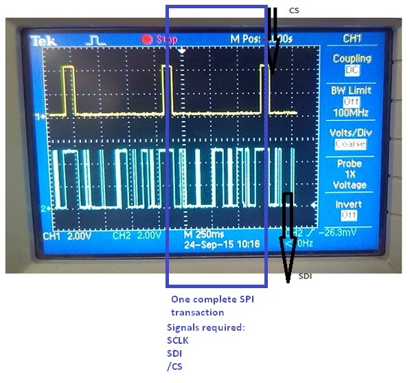

  • Howdy arti,
    Thanks for the information.  In order to verify timing specifications I will need a complete capture of the following signals during a complete SPI transaction.

  • Hi Matt,
    Kindly find all waveform.and one more thing i want to ask,in Schematic I have connected RST pin to 5V,Vmon is open ,Ain is open ,GPIO0 and GPIO is open becuse iam not using these pins,and LATCH defined as output of controller and input of DAC7716. Please verify and let me known i did correct.DAC7716 waveforms(24.9.15).docx

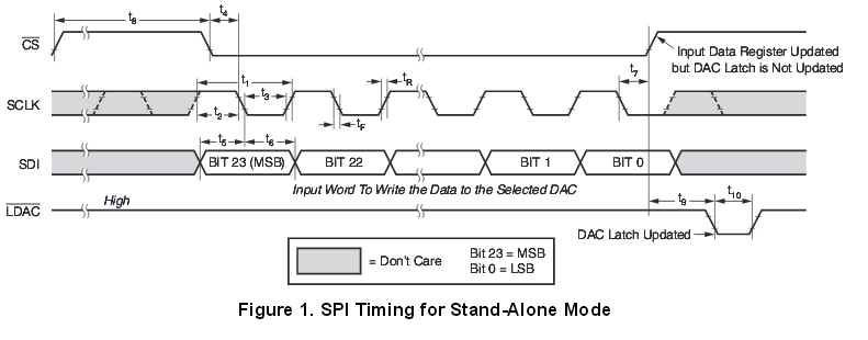

  • You need to zoom into one transaction as well as provide me with the write details of the transaction.  For reference I've included the below images.  One complete transaction is described as one SPI register write which follows the following illustration.  Note how the CS signal asserts low for one transaction.  I've highlighted what you would need to zoom-in in the image you've provided.  Please also list the 24 bit value you are trying to write to the device for the captured SPI write.
    Can you also include all 3 signals in one scope capture (SDI/SCLK/CS)?  If you only have a 2 channel oscilloscope then (SCLK/SDI) will do but verify that the transaction only lasts for one active low /CS.
  • The /RST/GPIO/Vmon pin connections are fine. However, usually the active low inputs are tied to a pull-up resistor to IOVDD. If you plan to use GPIOs in the future it may be good to note that most have open drain outputs, therefore a majority of the times you will need a pull-up to IOVDD as well.
