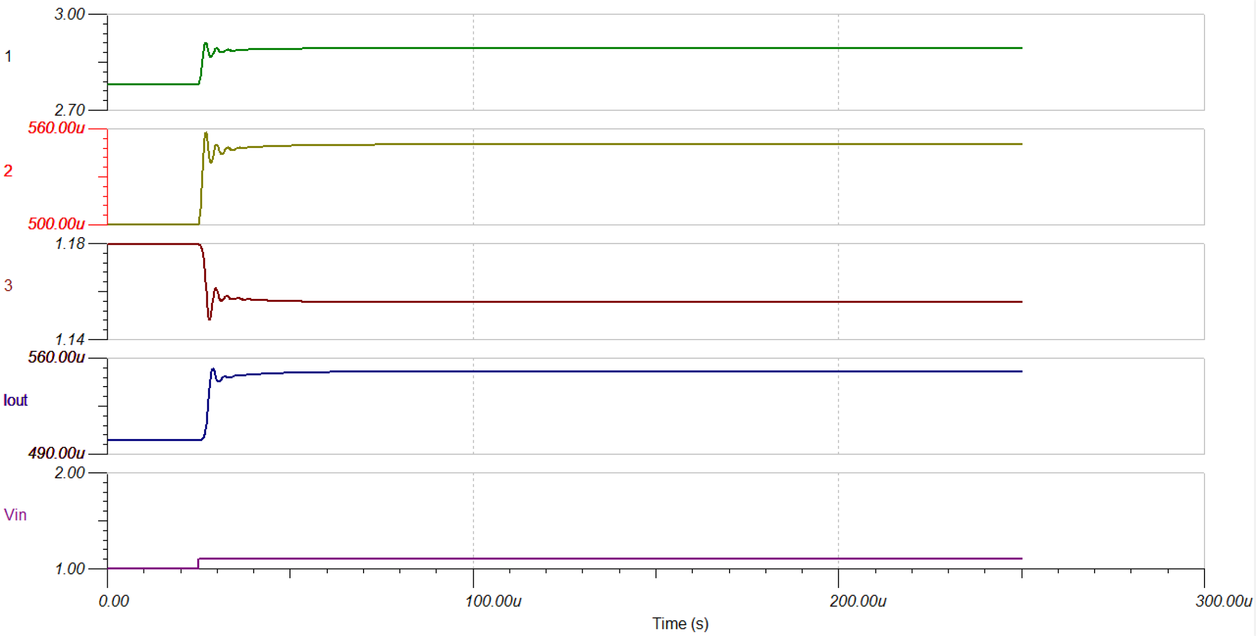

  • Kevin,
    Thanks a lot for the reply. I found your solution to be ideal for my application.
    I modified the simulation circuit( Gain setting Rs3 = 4.7 Ohm to 470 Ohm) and followed the reference document in adjusting the stability network.(R5,C7).
    The AC response looks stable and the output looks accurate.
    Do you mind checking this circuit see if there is anything i can improve on the circuit?
    Also 2 questions:
    1) Is there a example board for sale?  (  Since my circuit is very similar to the circuit from the tested example circuit. I would like to do a quick prototyping)
    2) What kind of load can this circuit drive?
    My understanding is that as long as the PMOS remains in Active region, The circuit will work and current output should be accurate.
    I am designing the circuit to bias transistors. (Current mirror). Will this circuit work?
    Eddy
  • Eddy,
    It seems like you have done a good job following the reference design, I do not see anything that needs to be modified at this point.
    Generally speaking we do not keep PCBs on hand of these TI Designs and do not stock them for purchase, that is the case for this particular design as well, so unfortunately we cannot ship one of these designs to you for prototyping.
    Your comments about the maximum load are correct. Usually this headroom requirement for the voltage drop across the resistor and the requirements to keep the output FET in the linear region of operation is referred to as "Compliance Voltage".

  • Hi Eddy,
    The MOSFET devices in this design are inside the feedback loop of the op amps that control them.  Therefore, the op amps will use negative feedback to control the MOS Vgs voltage to achieve the desired current through the sense resistor.  The low-level currents of 0-1mA that flow through the NMOS device requires a very small VGS voltage to achieve.  Driving the FET with a voltage well above the threshold voltage would force the FET to a low-impedance state which would allow too much current to flow through it.
  • Hi Kevin and Collin,
    We got the circuit tested out today, It works great!
    Thanks a lot for your helps,
    Eddy
