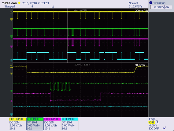

  • Hi Cafain,
    Would it be possible for you to show scope/logic analyzer plots of when you see the pulse on DRDY with respect to any communication?  A little more explanation of when you see this pulse would also be helpful.
    Is there a specific issue you are seeing with the results, or is this  just a question of operation?
    Bob B

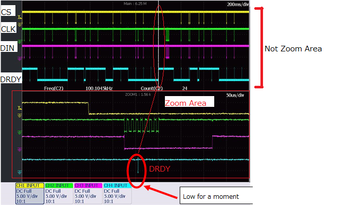

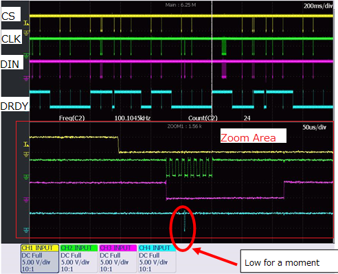

  • Hi Bob B,
    Thank you for your reply.
    I post the waveform below instead of cafain.
    There is a specific issue I am seeing with the results.
    Red circle focuses that DRDY become low for a moment.
    It is not expected timing. I guess that it caused by DYSYNC command.
    Do you have idea to avoid this?

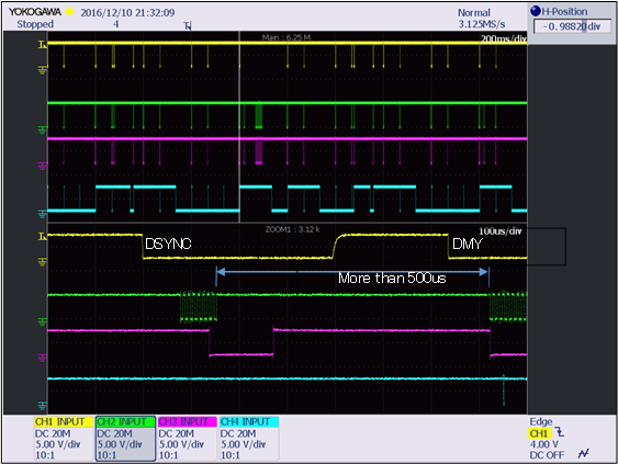

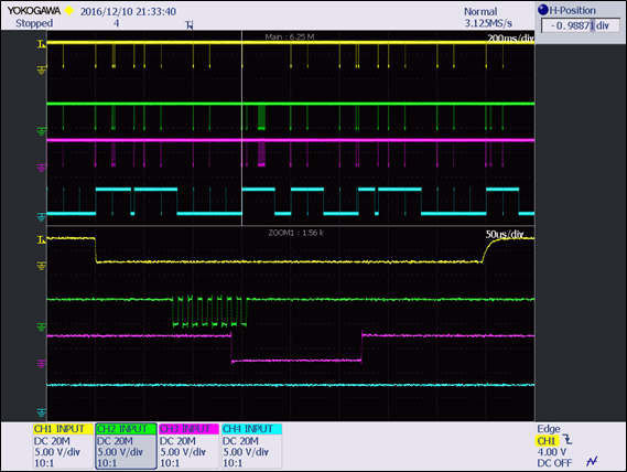

  • Hi ttd,
    What is confusing is the white line is covering over exactly the area of the communication and it doesn't appear to match the zoomed plot.  DRDY is already high in the zoomed plot, but it appears low in the normal plot window.  Based on where the white line is, I would say that the pulse shown is the end of conversion period and would be normal unless the DSYNC command is sent prior.  Can you point out where the DSYNC command takes place on the not zoomed area?
    Bob B.
  • Hi Bob B,
    I attached 3 waveform below.
    Could you chek them?
    ■DSYNC-DUMMY(Yellow:CS Green:CLK Pink:DIN Blue:DRDY)
    ■DSYNC(Yellow:CS Green:CLK Pink:DIN Blue:DRDY)
    ■DUMMY(Yellow:CS Green:CLK Pink:DIN Blue:DRDY)
    ttd

  • Hi ttd,
    Looking through the plots that you've provided, the communications look ok. Based on the plots, the data rate seems to be 15 Hz. With the SPEED bit = 1, and DR bits = 00, the fOSC should be 4.9152 MHz and the fMOD should be 19.2 kHz. Also based on the plots, the SCLK period is about 10us, so the communications should be slow enough for the device to read everything clearly. I'm verifying the timing, so if there's anything that isn't correct, let me know.
    However, I did have some extra questions about the problem. When you see the momentary /DRDY low, how narrow is the pulse? I noticed from two different plots that the momentary /DRDY low seemed to occur at the same place (between the third and fourth SCLK low during the dummy write after the DSYNC command). Does this momentary low always occur here? How often does this occur?
    At this point, I'm not sure what the problem is. Can you change your program to disable the interrupt during the DSYNC command and the dummy write? It might be useful to know if the problem goes away.
    Joseph Wu
