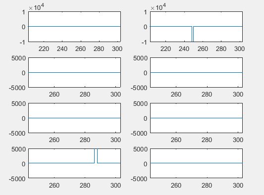

I use a CC2530 board connect with the ADS1299EEGFE-PDK daughter board.
 I read chipID and got correct value.
Then I  I wrote and read configs according to datasheet page 62(Setting the Device for Basic Data Capture )
In fact,I read some previous posts. According the post of .(ADS1298: Run Test Signal and measure heart rate using two electrodes)
I read 27 bytes from buffer a lot of times,and form a [n x 8] matrix to store the signal.And I use the matlab test the  internally  test signal.
Here is my data and the image of a channel. The image looks like square-wave? AM I WRONG?

  • Hello user4818433,
    The raw data you posted is correct, but the plot is wrong. The data which comes out of the device is in binary 2's complement. This means that data where the 1st bit is 1 is negative. Table 9 in the datasheet shows how to convert codes to voltage.
    Brian

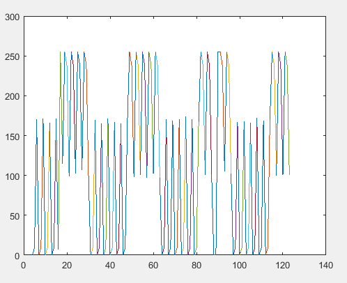

  • Dear Sir,in fact I have some question about what you said in this post: The positive code should be roughly 0x000E and the negative code should be roughly 0xFFF2.
    e2e.ti.com/.../581842
    That's why?.According to the data I get from the MCU,both the peak and the trough of the square-wave are a 2-bytes hex.
  • oh,I think I find the answer,the three bytes of each channel would read toghter !
  • user4818433,
    You are correct. The data will be 24-bits or 3 bytes.
    Brian

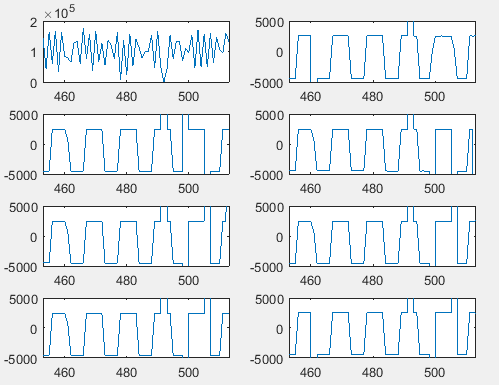

  • Hello,Sir,
    Finally I get the square-wave,but the image seems to have a lot of noise.(the first channel is seted  to normal electrode mode)
  • Oh!I forgot it,that's why?
    Is this resolved? If you leave the inputs floating and attempt to measure the voltage, the result will not be valid.
    Brian

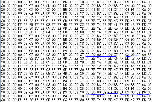

  • I found something wrong about my primary data get from the ADS1299.
    Like the line I marked.
    Why the data is wrong here? Is there some problem I ignored? Await your answer!
    I believe the problem is that you are not reading the data fast enough. In continuous read mode, data is automatically loaded into the output shift register of the device whenever DRDY asserts. This means that if it takes longer than the period between DRDY assertions to read the data, the data you read will be corrupted by new data.
    You can see this in the data you highlighted. In the first one, not the first byte underlined in blue is 0xC0 which is exactly how the status byte begins. in the second area you underlined, the byte directly before the one you underlined is 0xC0 indicating that point, too, has been corrupted by a slow data read.
    To fix this issue, you can increase the SPI clock frequency, or decrease the delay between the time DRDY asserts and you begin reading data.
    Brian Pisani

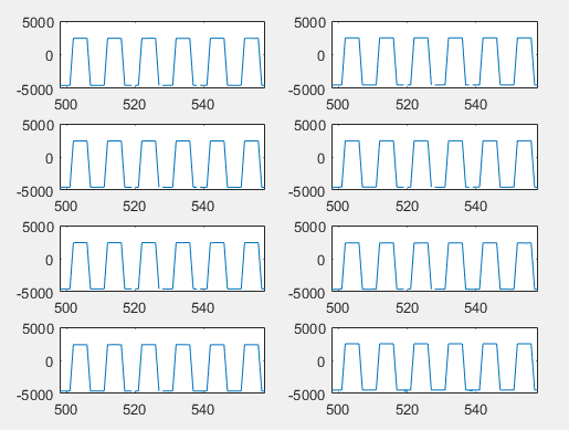

  • Hello,sir.
    Finally I get the square-wave,but mine is different from the datasheet and others' .
    A cycle of mine is just less than 10 sampling points.The datasheet is almost 120.
    That's why? I wonder the problem is my delay before my 8 channels' data reading or not.
    Please give me some advice.
     Wait for your reply.
  • I guess it just because the delay.For my delay is 100ms and my cycle is 10 points.when my delay is 50ms and my cycle is 20 points.
    And as for 250 sps data rate,the cycle is just about 250 points
