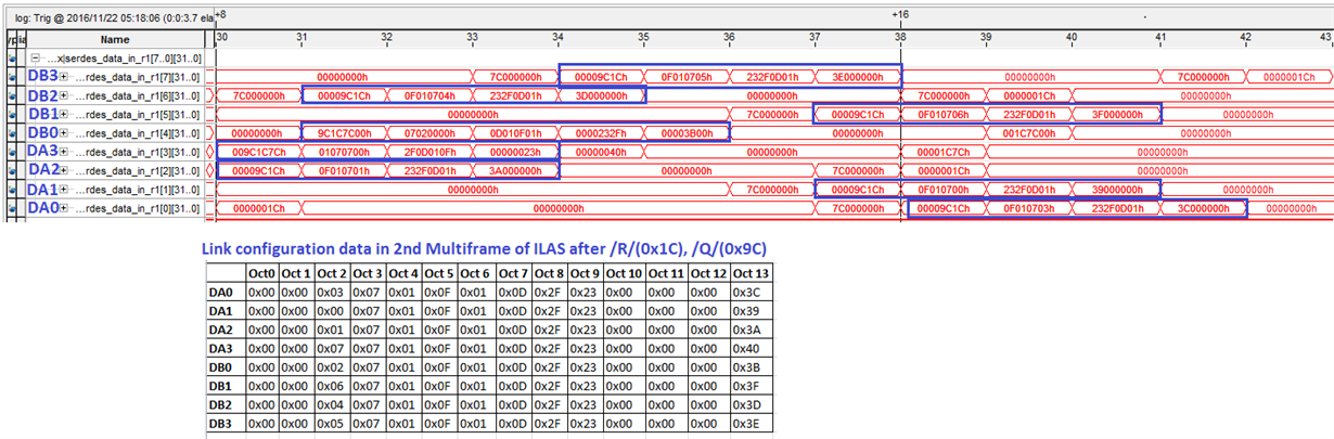

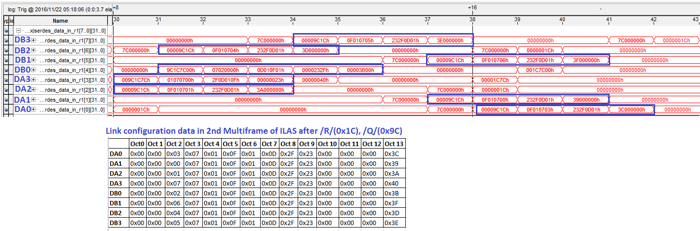

    I'm working with Björn on this design. We manage to set up the ADC (we think) and we can control K28.5 and data transmission. But what we get from the ADC is very odd.
    We set up the ADC as LMF=421, no decimation. When we start transmission, the link appears to work. No symbol errors, no 8b10b decoding errors. But the ILA data is very strange:
    # FPGA JESD lane 0 recorded ILA [byte order in ILA sequence]
    0x1c010000 [3,2,1,0]
    0x12011700 [7,6,5,4]
    0x008000cf [11,10,9,8]
    0x0000c500 [xx,xx,13,12]
    Expected data would be:
    0x03000000 [3,2,1,0]
    0x0f011700 [7,6,5,4]
    0x0080002f [11,10,9,8]
    0x0000xx00 [xx,xx,13,12] (I haven't calculated check sum)
    Can we trust the data? And which lane is which? What we think is lane 2 is named lane 28...
    Can you explain this? See the sequence below.
    Anders
    # FPGA JESD lane 1 recorded ILA
    0x1c000000
    0x12011700
    0x008000cf
    0x0000c600
    # FPGA JESD lane 2 recorded ILA
    0x1c1c0000
    0x12011700
    0x008000cf
    0x0000c300
    # FPGA JESD lane 3 recorded ILA
    0x1c020000
    0x12011700
    0x008000cf
    0x0000db00

    And this is what the raw 8b10b decoded data look like (lane 3). With K=24 (0x17+1) and F=1, a multiframe is 24 octets, or 6 words:
    bcbcbcbc
    bcbcbcbc
    bcbcbcbc
    bcbcbcbc
    bcbcbcbc
    bcbcbcbc
    bcbcbcbc
    bcbcbcbc
    bcbcbcbc
    bcbcbcbc
    bcbcbcbc
    bcbcbcbc
    04e3041c  <- Here is start of ILA sequence, multiframe 1. 0x1c=K28.0
    4.04E+07
    00e3e3f8
    04e3e304
    e3e30004
    7ce3eb04  <- Here is end multiframe 1. 0x7c=K28.3
    00009c1c  <- Here is start of multiframe 2 and ILA config. 0x9c=K28.4, which is ILA config start
    17001c01
    00cf1201
    c5000080
    04eb04f8
    7c08f8eb  <- Here is end multiframe 2. 0x7c=K28.3
    13eb001c  <- Here is start of multiframe 3
    080000f8
    04e3f0f8
    00f8f8e3
    8.04E+302
    7c000004  <- Here is end of multiframe 3
    0800001c  <- Here is start of multiframe 4
    e304f8e3
    00e3f800
    4.00E+05
    13e30404
    7c040000  <- Here is end of multiframe 4, and also end of ILA sequence
    e3e30013  <- Here starts user data.
    04f800e3
    08e308e3
    f8000808
    ebebebf8
    4.00E+302
    e300f804
    e3f8e304
    4040404

  • Hi Jim,
    Thanks for quick response.
    We are still confused on the captured ILA sequences. We believe that we have configured the ADC to LMF=421 (see previous mails on setup)
    Lane 0: (byte 13 downto 0)
    0xbc_00_00_80_c0_cf_12_01_1f_00_1c_01_00_00
    Lane 1:
    0xa2_00_00_80_c0_cf_12_01_1f_00_1c_00_00_00
    Lane 2:
    0xba_00_00_80_c0_cf_12_01_1f_00_1c_1c_00_00
    Lane 3:
    0xa4_00_00_80_c0_cf_12_01_1f_00_1c_02_00_00
    As can be seen, these are showing the same configuration, only lane IDs and checksums are different. But the field information is partly corrupt:
    Fields according to JESD spec:
    LID (lane ID), byte 2: Lane 0 has LID=0x01 (expected 0x00), lane 1 0x00 (expected 0x01. Are they swapped?). Lane 2 0x1c (expected 0x02), lane 3 0x02 (expected 0x03)
    L (lanes in link), byte 3: L=0x1c (corresponding to 29 lanes(!). Expecting 0x03, as we have 4 lanes in the link)
    F (bytes per frame), byte 4: F=0x00, as expected.
    K (number of frames per multiframe), byte 5: K=0x1f, as expected (K=32)
    M (number of ADCs in link), byte 6: M=0x01, as expected (2 ADC channels)
    N (converter resolution), byte 7: N=0x12 (Resolution 19 bits. Expected 0x0d or 0x0f, depending on how the padded 14-bit sample is counted for)
    N' (Sample size), byte 8 (4:0): N'=0x0f, as expected (16 bit samples)
    SUBCLASSV (JESD type compliance), byte 8 (7:5): SUBCLASSV=0x6 (illegal value, expected 0x1)
    S (Samples per ADC per frame), byte 9 (4:0): S=0x00, as expected.
    JESDV (JESD version), byte 9 (7:5): JESDV=0x6 (illegal value, expected 0x1)
    HD (High Density mode), byte 10 (bit 7): HD=0x1, as expected.
    FCHK (checksum), byte 13: Doesn't match ILA content on any lane.
    So our questions are:
    1) Can we rely on the configuration? Illegal values in fields, strange number of lanes, etc, make us confused.
    2) Can we be sure that our lanes are in the right order? Is our expected lane 0 really the true lane 0 in the link?
    Anders F

    The data you captured for ILA is not showing the 9C (Q) value. Please see attached. Is there a chance you are capturing data from another frame? This should be from the second multiframe and should start with 1C followed by 9C. The data shown is from our ADS54J60 that is from the same family as the ADS54J42.
    Jim
  • What you see in "Lane X ILA sequence" is the captured 14 bytes of ILA configuration data, i.e. what is present after the Q character.
    There is no use for us to store the sync characters in FPGA memory. We only store the interresting part, i.e. the 14 ILAS bytes.
    I'll try to detail which bytes are which using Lane 0 as an example:
    # Lane 0 ILA sequence:
                                           READ DATA        ILA byte number corresponding to read data
    poke 0x43c001fc 0 | peek 0x43c001fc => 0x1c010000       03 02 01 00
    poke 0x43c001fc 1 | peek 0x43c001fc => 0x12011f00       07 06 05 04
    poke 0x43c001fc 2 | peek 0x43c001fc => 0x0080c0cf       11 10 09 08
    poke 0x43c001fc 3 | peek 0x43c001fc => 0x0000bc00       xx xx 13 12
  • 1C is not a ILA byte parameter. The fourth octet (03 byte) is the # of lanes -1, which we record as a 3. I have captured the ILA data with an ADS54J42EVM using your settings and I get the following:
    Lane 0 : 0, 0, 1, 3, 0, 1F, 1, D, 2F, 20, 80, 0, 0, 43
    All of the other lanes have a different ID and checksum. As far as I can tell, the data is coming out correctly except for the checksum. This value should be the sum of the first 12 parameters then mod 256. I cannot figure why we are seeing a 43 for lane 0. I am checking with the design team regarding this.
    Jim
  • Bjorn,
    For the checksum issue:
    Then check sum is summation of all 20 fields then mod256.
    The 20 fields span over 13 Octets. If you sum each field individually in this example, you would get the correct check sum for each lane. I was originally combining a couple of the fields, thus giving me a wrong a checksum value.
    Jim
  • Really strange.
    I have captured the ILAS sequence using chipscope once again:
    I have also created a script that extracts the ILAS fields (with +1 compensation for the fields thar are value - 1 entered):
    DID: 0 BID: 0 ADJCNT: 0 LID: 1  PHADJ: 0 ADJDIR: 0 L: 29 SCR: 0 F: 1 K: 32 M: 2 N: 19 CS: 0 NP: 16 SUBCLASS: 6 S: 1 JESDV: 6 CF: 0 HD: 1 RESERVED: 0 RESERVED: 0 FCHK: 188
    DID: 0 BID: 0 ADJCNT: 0 LID: 0  PHADJ: 0 ADJDIR: 0 L: 29 SCR: 0 F: 1 K: 32 M: 2 N: 19 CS: 0 NP: 16 SUBCLASS: 6 S: 1 JESDV: 6 CF: 0 HD: 1 RESERVED: 0 RESERVED: 0 FCHK: 162
    DID: 0 BID: 0 ADJCNT: 0 LID: 28 PHADJ: 0 ADJDIR: 0 L: 29 SCR: 0 F: 1 K: 32 M: 2 N: 19 CS: 0 NP: 16 SUBCLASS: 6 S: 1 JESDV: 6 CF: 0 HD: 1 RESERVED: 0 RESERVED: 0 FCHK: 186
    DID: 0 BID: 0 ADJCNT: 0 LID: 2  PHADJ: 0 ADJDIR: 0 L: 29 SCR: 0 F: 1 K: 32 M: 2 N: 19 CS: 0 NP: 16 SUBCLASS: 6 S: 1 JESDV: 6 CF: 0 HD: 1 RESERVED: 0 RESERVED: 0 FCHK: 164
    Here I think it is strange that the NP value is smaller than N (or I just missunderstand the meaning), SUBCLASS=6, JESDV=6, L=29 and LID=28.
    Can you please forward our strange ILAS as well to the design team and ask if they have a clue what is going on?
