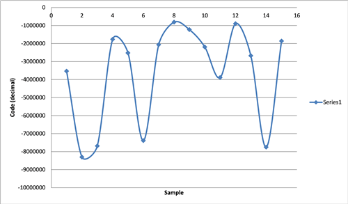

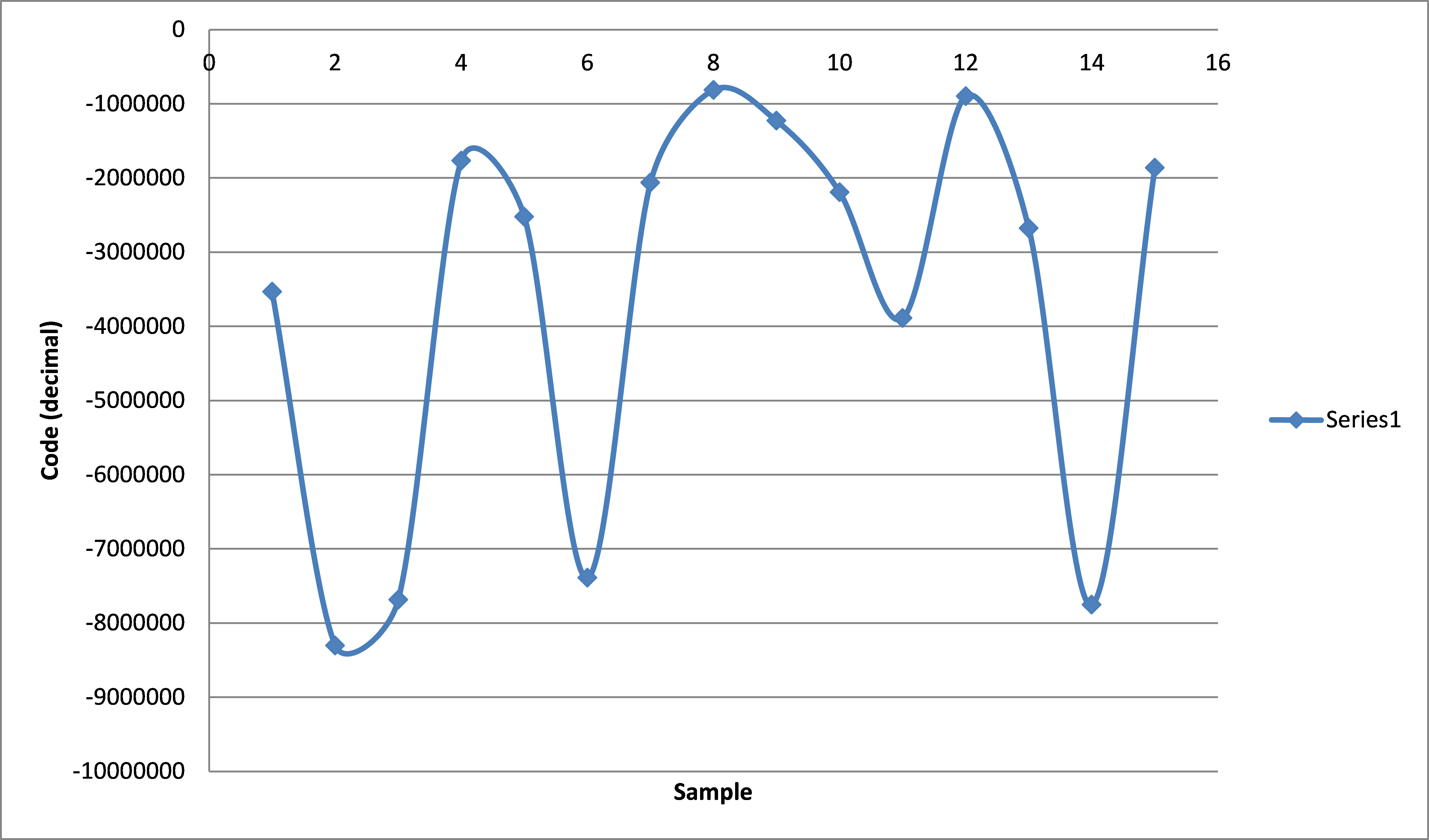

  • ADS1292 Characterization.docxRyan,
    I have attached the file again.  I hope the Beagle Capture data will give you some insight.
    Joe
  • ADS1292Schematic.pdfRyan, Attached is the schematic the hardware designer gave me. He said he got it from a eval. kit. I apologize for it's appearance.
  • Hi Joe,
    Thanks for the updates. I looked through the characterization document. Channel 1 is definitely saturated, while Channel 2 seems to show some noise at least; however, if you say that all inputs are grounded, then there is quite a bit more noise than I would have expected.
    Can you please share the complete register settings for the device? Did you try configuring either channel to use the internal square wave test signal? There's an example of how to do that at the bottom of Figure 63 in the datasheet.
    Your data (lines 46 - 88):
    Code (Hex) (Code) Decimal
    ca1053 -3534765
    814c49 -8303543
    8ab8c2 -7685950
    e5109b -1765221
    d97fad -2523219
    8F3d8a -7389814
    e07cfe -2065154
    f39963 -812701
    ed3bf6 -1229834
    de8c1c -2192356
    c4a85c -3889060
    f24aed -898323
    d72c58 -2675624
    89b579 -7752327
    e39968
    -1861272

    The structure for the RREG and WREG commands calls for the number of registers to read / write minus one. Therefore, to read from / write to two registers, the second byte in the SPI command will be 0x01. You are sending 0x02 as your second byte (meaning you wish to read / write three registers), but you're only sending enough SCLKs for two registers. Hope that clarifies the command structure.
    The test signal appears to be configured properly for channel one and 0x0049F2 is in the correct range. For VREF = 2.42 V and Gain = 6, the LSB size is equal to 48.081 nV (see equation below). Therefore, 0x0049F2 (18930d) equates to 0.9102 mV. The expected amplitude of the square wave test signal is 1 mV.
    1 LSB = [2*VREF / Gain / 2^24] = 48.081 nV
    18930 * 48.081 nV = 0.9102 mV
