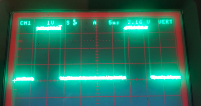

Examining this line on a scope caused some concern.
This happens with both ADS1015's and on both READY/ALERT lines.

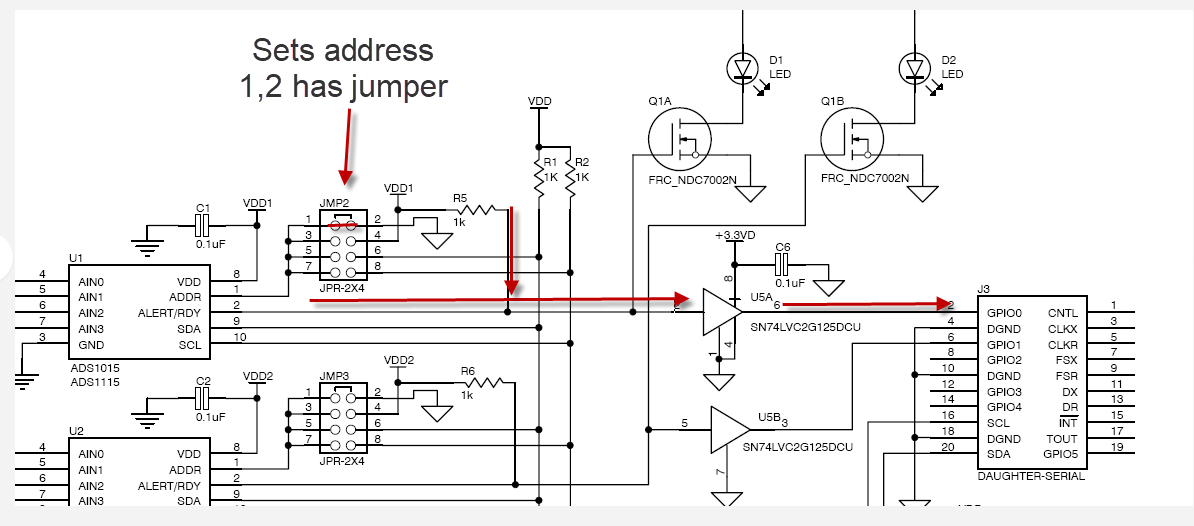

This is quite perplexing.  I see the same ragged crappy signal on both sides of the non-inverting buffer, U5.
Here's a snip of my ADS1015EVM schematic:
This is rather late in the game for our development commitment to this device.  So would be good to know, ASAP, if we can use READY/ALERT on this chip.  At the moment, this seems unlikely.

  • Yes, I have good grounds. However I am NOT supplying +3.3V at J2. Only +5V. If I supply +3.3V the ratty pulses go away and I get nothing on ALERT/RDY.
    It appears that the +3.3 is needed for the level shifting. However, my TWi works fine without it...

    The level shifting is needed for the PDK version we had of the ADS1015 as the motherboard (MMB3) is 3.3V only. You should be able to jumper pins 9 and 10 on J2 and all should be happy for the whole board. 3.3V is not a requirement unless using the MMB3 motherboard. However it is best to power the unpowered devices on the EVM.

    As I noted, when NO +3.3V was applied to J2, I saw these pulses, but they were very ragged and did not reach GND.  What's strange is that I had not set up the comparator as you suggest and saw these pulses.  So not certain what's (still) going on.
